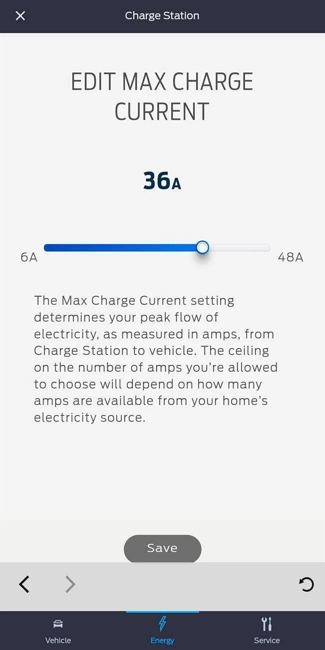

Be careful with getting anywhere close to max amperage on that dryer line. The circuit is not designed for high continuous draw at max amperage. The codes for EV wiring vs most any household load is different. Your dryer doesn’t pull 24A continuously, it cycles. The EVSE will pull 24A continuously, and it has higher wire gauge requirements. Best to have an electrician out to inspect and advise. See what gauge wiring you have to the dryer outlet and set your EVSE appropriately.

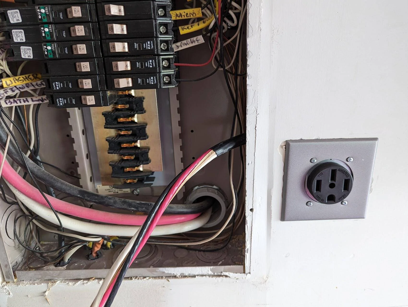

Thanks. The electrician from QMerit agreed with you. Said the wiring not able to handle load. Decided to run wire from electrical panel on side of house across through the crawl space and down into the garage.
Most people don't realize it but the "Dryer" outlet is not designed to handle the voltage for a long period of time, it will work but over time it will melt. Very dangerous. The best 240 plug to use is the Bryant Electric 9450FR 50 Amp outlet. Make sure the electrician knows this.
The wiring and receptacle are fine. You just have to derate to 80% of the dryer circuit breaker amps as an EV charger is a continuous load. So, a 30 A dryer circuit can at most run a 24 A EV charger.
