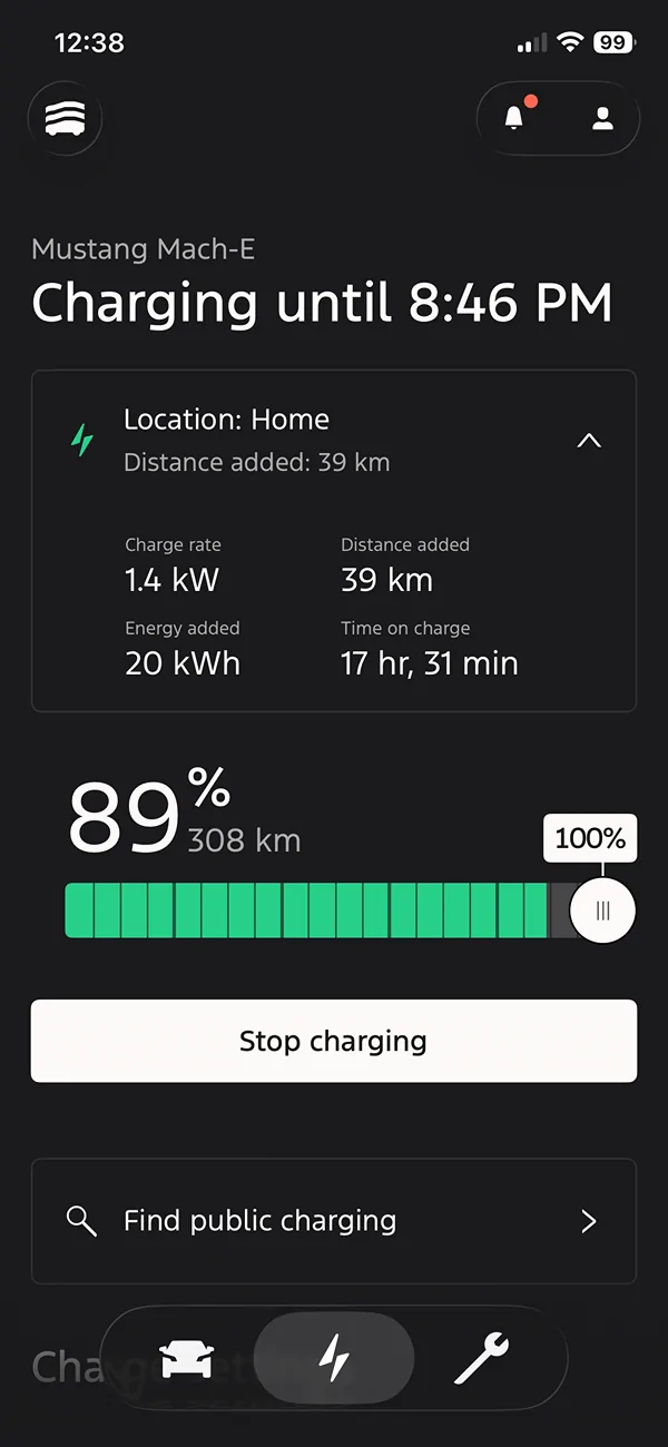

I'm curious then why the Ford app is showing 1.5 kW being drawn. Well, allegedly showing. Haven't seen a screenshot showing it.
Here you go. Finally used the charger again. Showing between 1.4 and 1.5 today.
