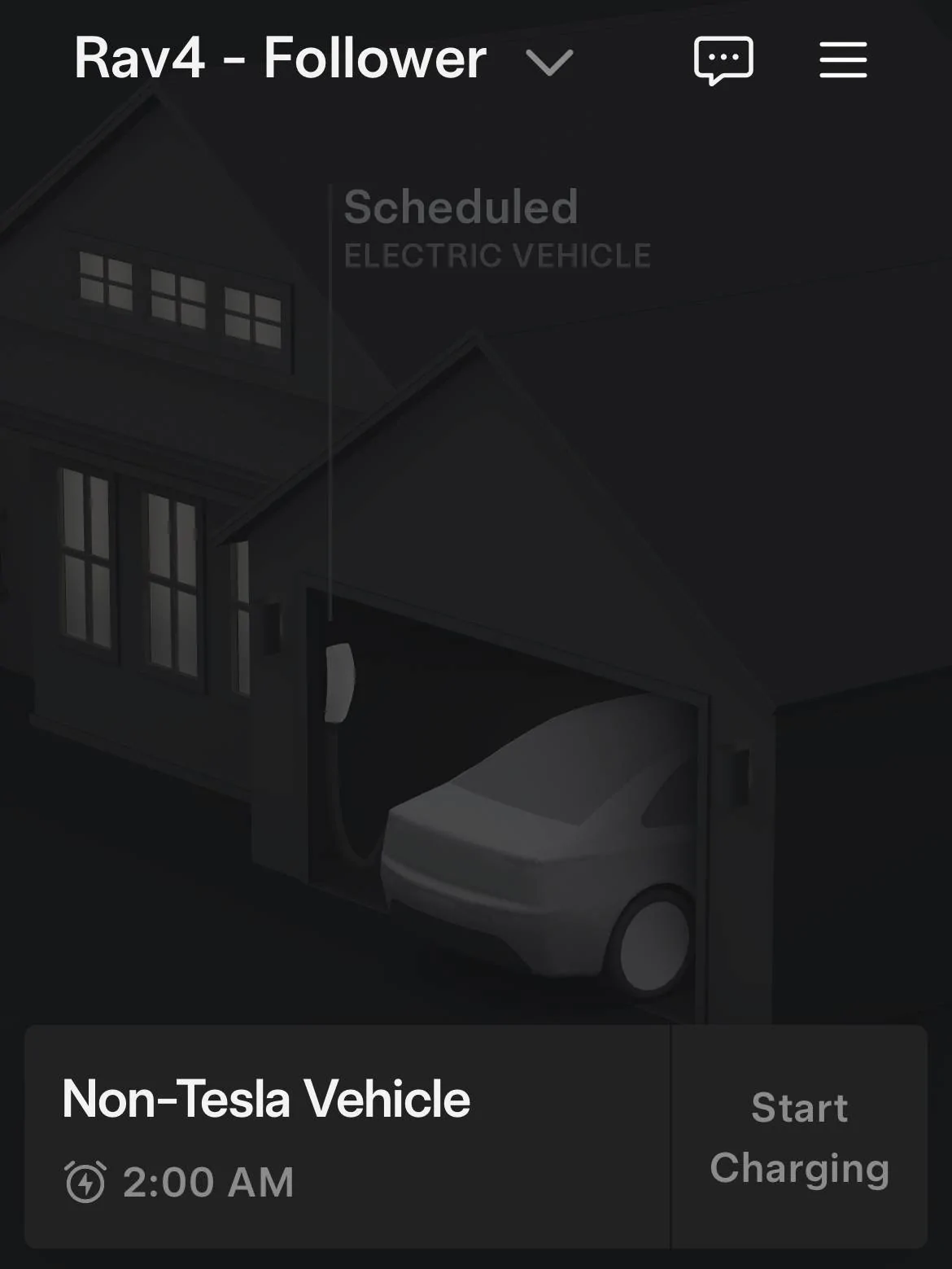

I’ve been successfully charging on a dryer outlet since I bought my first EV in 2013. I charge pretty much every night and I don’t recall ever waking up to a car that was not fully charged. All that’s needed is an EVSE that can be set to 24 amps max continuous (not the Ford unit). Currently I’m very pleased with my hard wired Tesla Wall Connector.

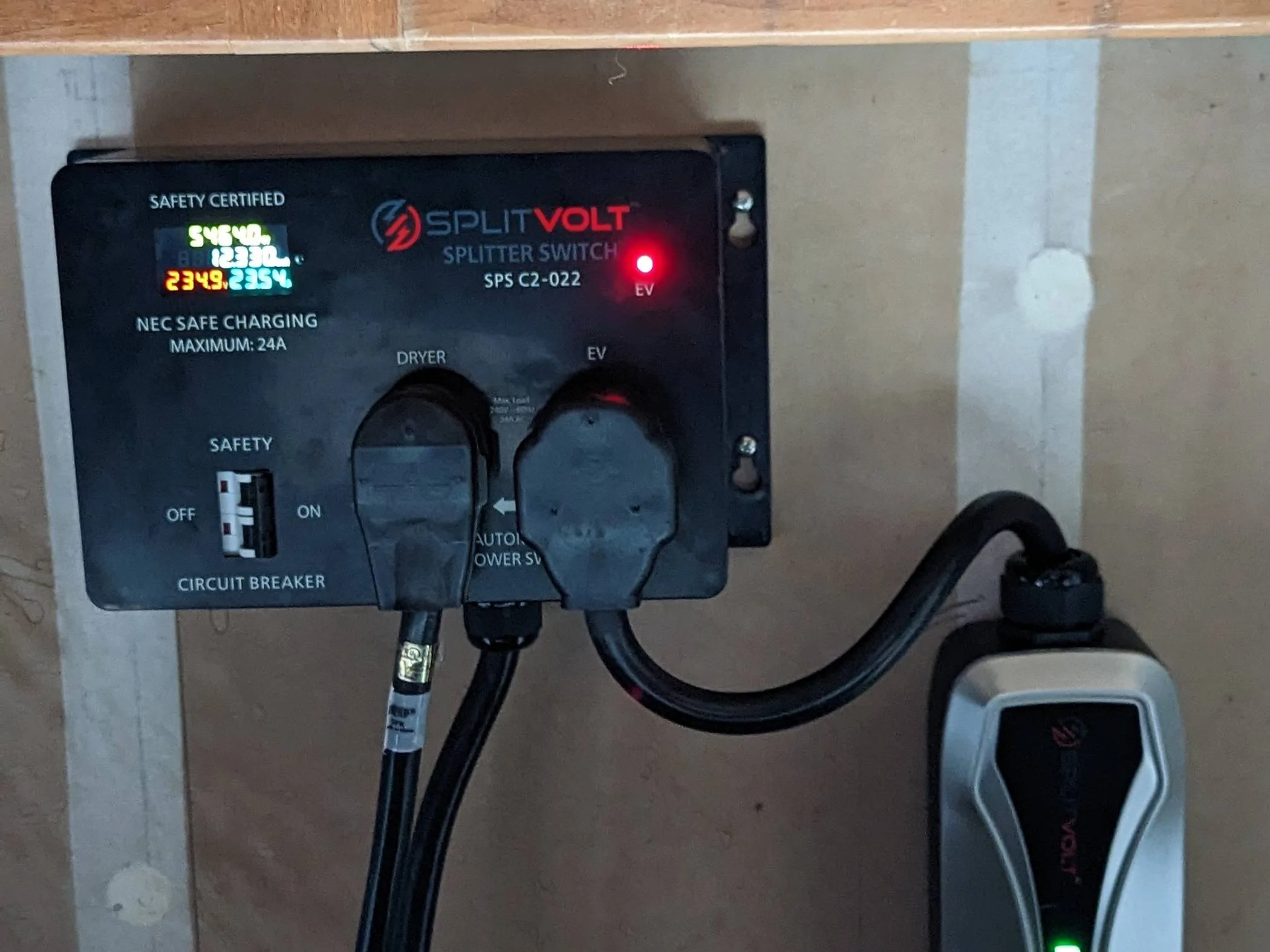

I use a Dryer outlet to charge but I got a SplitVolt switch and a SplitVolt charger for 10-30 which is the type of dryer outlet I have. You cannot use a 14-50 charger on a 10-30 or 14-30 outlet since those are 30 amp max and the 14-50 is a 50 amp outlet but requires the correct wire cable to the outlet to withstand the higher current level. The Ford charger cannot be dropped to the lower current. My SplitVolt charger draws just under 24 amps which is about the most you would want on a 30 amp circuit at continuous use. The SplitVolt switch will switch between the dryer and the charger when the dryer is started. I have not done it since I make sure not to use the dryer when the car is plugged in. Otherwise the dryer seems to work like it always has.
WE do the same thing....my husband did a lot of research before we bought the car. We have a ranch style house and our electrical panel is on one end and the garage on the other so it was going to be ridiculously expensive to run another 220 line. We did have an electrician come out to inspect our dryer plug and make sure it had the proper grounding, etc. We purchased the Split Volt switch and charger and have not had any issues. :)

A second (or third or fourth) recommendation for the Splitvolt system. It's specifically designed for your scenario, and includes a local circuit breaker for an additional level of safety. In my experience, 24A is plenty for charging.
