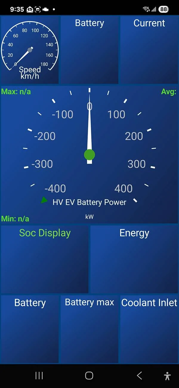

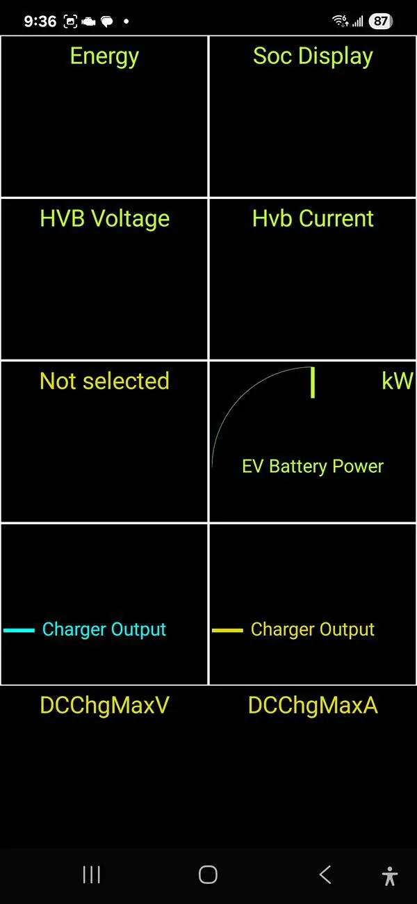

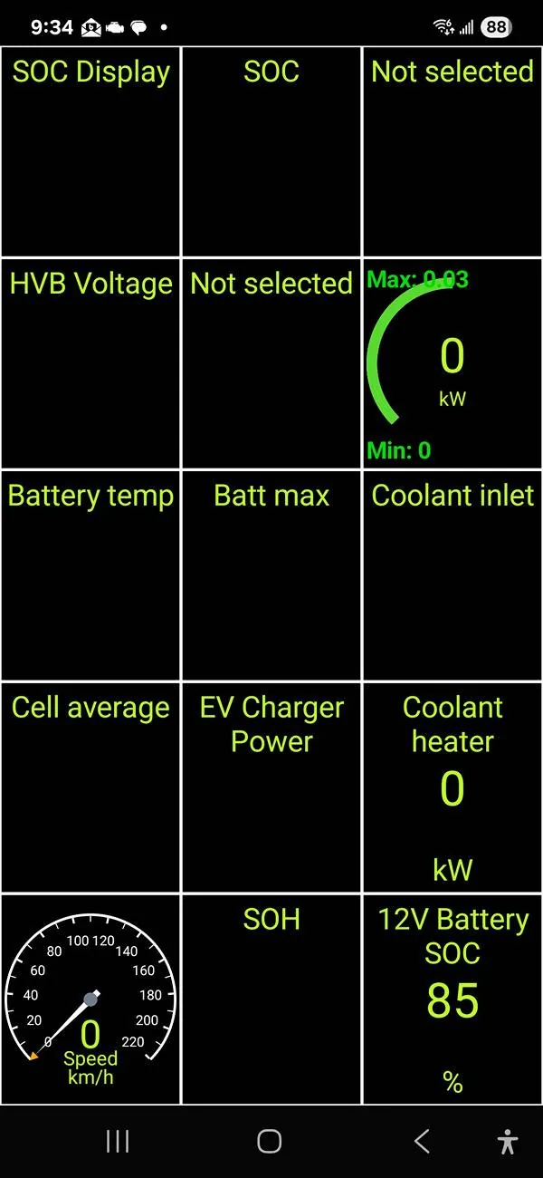

Will someone know why Car Scanner will not populate all fields like on the attached screenshots? The OBD is Vgate Vlinker MC+ connected to Mach-e 2025 Premium AWD Extended. The connection is fine. It used to work OK on Mach-e 2023.

Because the 2025s use an encrypted CAN bus, so you won't be able to access those parameters anymore. Car Scanner no longer works on 2025s.
