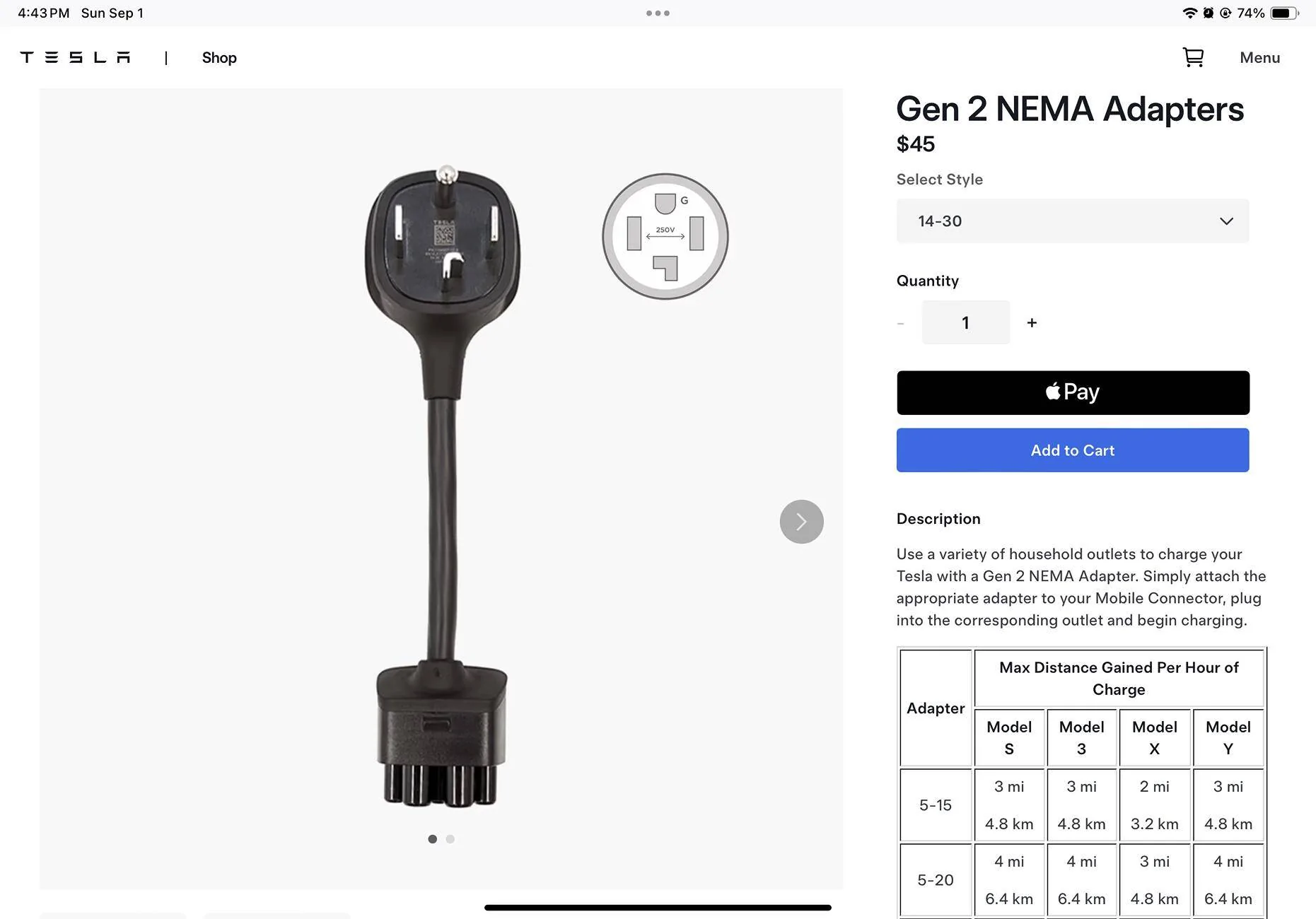

That outlet is a 14-30 (30 A). Your charger has a 15-40 and is a 32A charger. You can find an adapter but you will blow the circuit breaker (hopefully that vs roasting the wires or outlet first).
What you need is a portable charger that can be run at 24A — the maximum you can safely operate on that circuit.
I just got a Vevor to replace my aging Ford unit.... pretty great value and you CAN dial down the max current. In your case you will need an adapter as well.
you can't beat this price at $146 !
