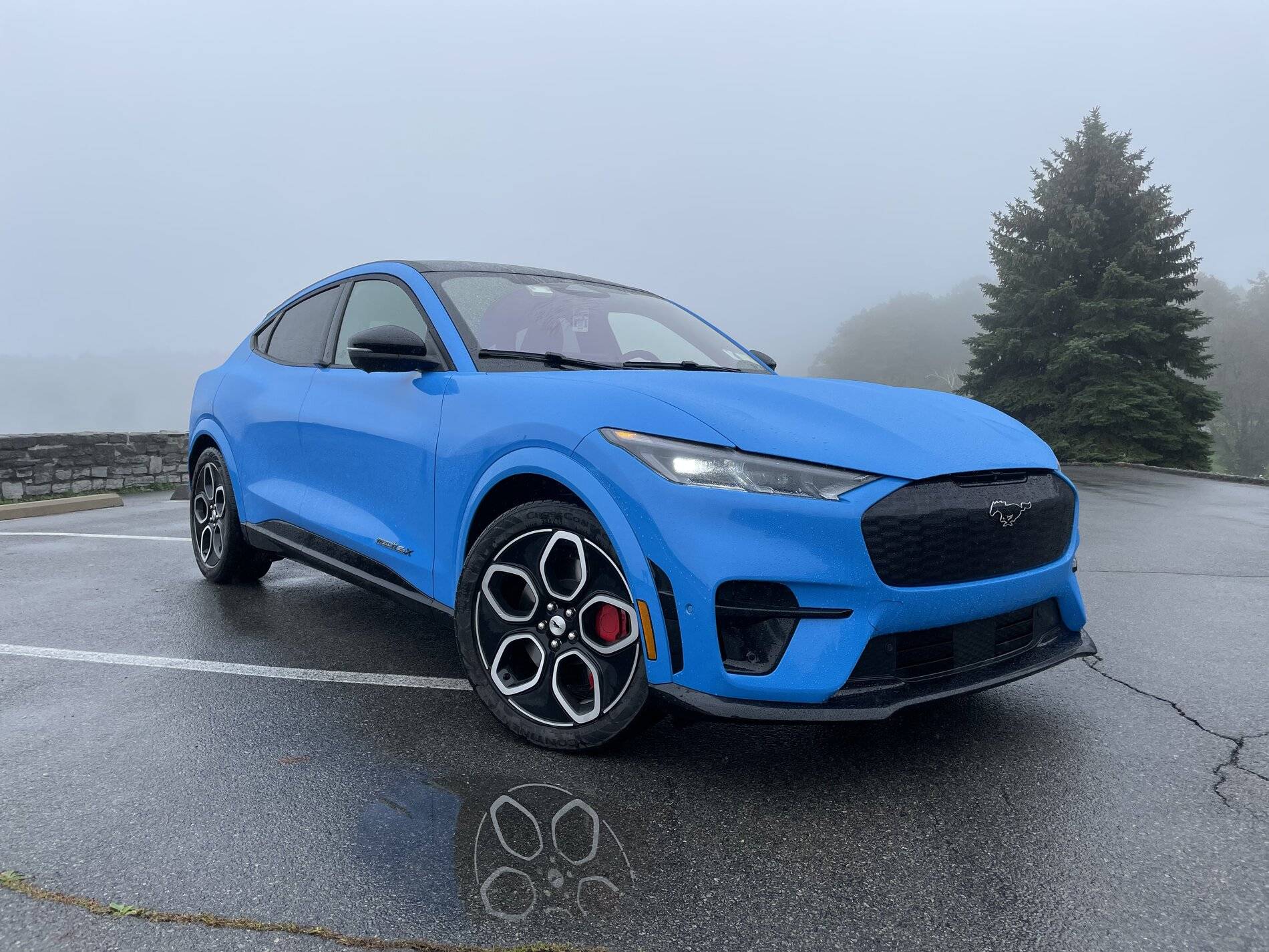

I just got back from a fun little wet-weather drive on some back roads in the hills around my place and thought of another reason to get a higher speed charger like the ChargePoint: it’s possible to drain the battery pretty quick on twisty ascents and if you’re in a hurry to get back home, you may not be coasting the descents to regen your battery. This is especially a concern when your friends are coming over to try the car out. Think how disappointed they’d be if you had to tell them to come back tomorrow when the Mach-E is finally charged. ?

I went from about 75 GOM miles to 49 miles GOM miles in 5 actual road miles! Fun but not really sustainable if you're in the middle of nowhere.
