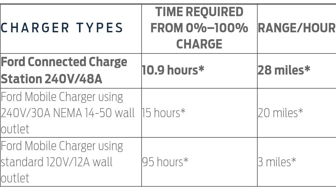

I was speaking with Ford customer service along the way while waiting for EV Mach E. Since it’s my first electric vehicle, I wanted more understanding of what I getting into. On some good advise from Ford, I have the webasto turbo 240v charger. This only required a 20amp in service box. The outlet plug required a NEMA 6-20R. The prongs are much smaller. This charger will fully charge my car in less time and be easier on my electric bill. On another note... my crash sensor has gone off 3 times when I was in NO danger of a crash. I know that this car has lots of sensors around the car. In one case I was at a 25mph in a town! There were parked cars on the side, maybe it just picked something up? Others were when I slowed down when a car in front of me was making a turn. I was wonder if anyone else has experienced this or if I should have it checked.
I think you've been misinformed. A 20A circuit will only safely handle a 16A load, which means you're charging at half the speed the included Ford Mobile charger is capable of providing and 1/3 the speed the car is capable of accepting. It will not be easier on your electric bill. You pay for electricity by the kWh, not the amount of time it takes to charge.

I had a ChargePoint HomeFlex installed because:
(1) I had no pre-existing 240v outlet;
(2) 120v is more inefficient (meaning wasted energy) than a 240v setup, and I also had no good 120v outlet based on where I wanted to park my Mach-E so some electrical work was going to be necessary no matter what;
(3) My utility offered a $500 rebate for installation of a smart charger, though only $300 for a dumb charger, which made getting the more expensive ChargePoint HomeFlex competitive with a lot of the more basic chargers - my hope here is that the ChargePoint is also a more premium product due to overall higher price in terms of build quality and the like aside from the smart management capability, but don’t really know if this is the case; and
(4) EVs seem to be the future, and I will likely want the ability to charge electric vehicles beyond in the Mach-E at some point so figured I would get the electrical work done now. The ChargePoint I don’t expect to last forever (though at least a very, very long time), but I do expect the electrical work to practically be something I never have to deal with again, not in 5, 10, 15, or 20 years if I end up staying in this house that long.

I just recently purchased a Mach e and I'm wondering why would anyone buy a charger like the grizz-le or FLO or any of them for that matter. Why not just get a 220V plug installed. It makes no sense to me to spend that money. Please enlighten me on why.
1. Convenience; not having to use my supplied portable plug in and out of my garage. Even with the best preparation where I live it could just end up a dirty or bothersome task to gather and store a ~25 foot cable every time I come and go.
2. Availability; just so happens a brand new in box unit was available on Craigslist near me and greatly discounted.
3. Location; I already have an outlet that the Ford plug could use. But, the location isn’t completely practical, I would be switching stalls with my wife whenever I wanted to charge. I prefer to be plugged in whenever it’s parked. I was able to install the box unit (hardwire) directly next to my stall on its own dedicated service.
4. Options; I prefer not be in a position where I only have 1 process or ability to charge this car, I’ve never owned an EV. So, I figure I’m buying either an extra portable cable or box unit. Price and availability determined that.
5. Impulse; ?
I understand the position, my work asked me about charging because they are going to install some
charging locations. I just recommended that they install 14-50 receptacles each with their own dedicated 60 amp service.
