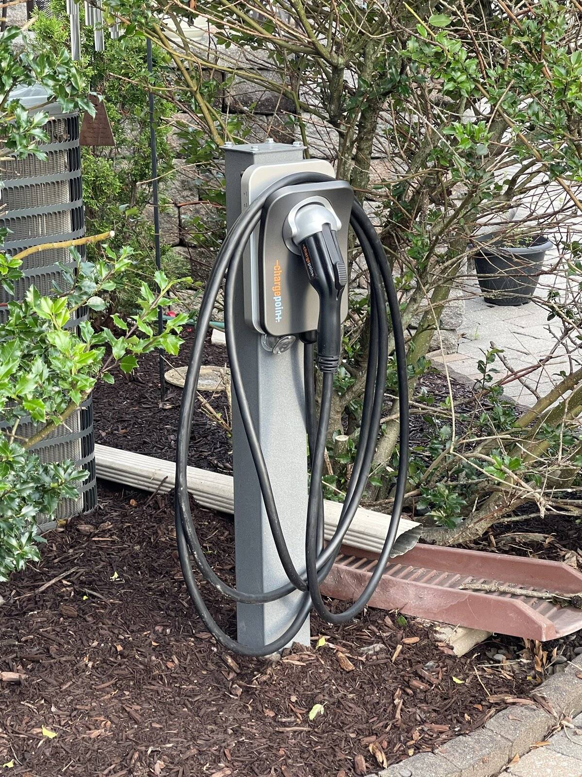

For me it was because I wanted a hard wired charger outside. The garage is full of toys, so I didn’t want to plug and unplug a mobile charger everyday in rain or snow. Instead I bought a 4x4 metal mailbox post from Lowe’s for $75, ran 3/4 sealtite inside and ended up with something the wife doesn’t hate.
Nice. That's one of the best looking outdoor setups I've seen.
Thanks. I’m pretty happy with how it turned out. I used one of those 36” mailbox mounting spikes too so if I ever want to remove it I can. The whole thing is very solid. If you’ve looked at the price of actual EVSE mounting posts or bollards, they are ridiculous!! Some sort of auto cord retractor would be nice, but I’m sure I can coil up my cord 2-3 times a week.
