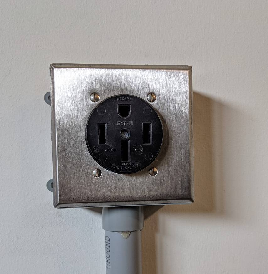

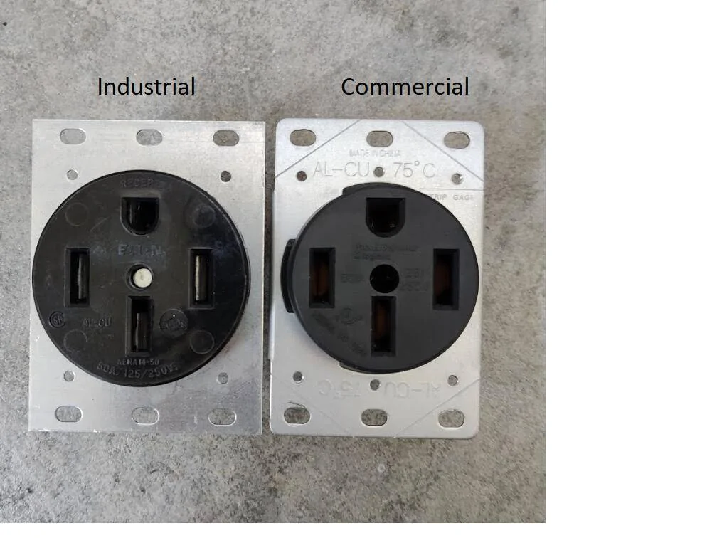

I ordered a chargepoint flex and I am going to have it hardwired.
I work at an industrial facility and spoke to the I/E manager here. He recommended hard wire over plug because those plug outlets do not hold up well over repeated use (plug/unplug cycles) compared to regular 120v outlets we commonly use.
They do if you get the right one. You need an industrial quality like a cooper or hubbell. These are the types of connectors used in hospitals where we are plugging and unplugging equipment all the time. It also handles continued high current for much longer than commercial grade home Depot crap. It's not that much more either. I bought a cooper (Eaton) 5745N. It's beefy. You need a different face plate for it too as it's larger.

The Tesla guys learned the hard way why Tesla specifically recommended an Industrial grade 14-50 over the commercial stuff when their home depot/lowes connectors were melting and catching fire.
