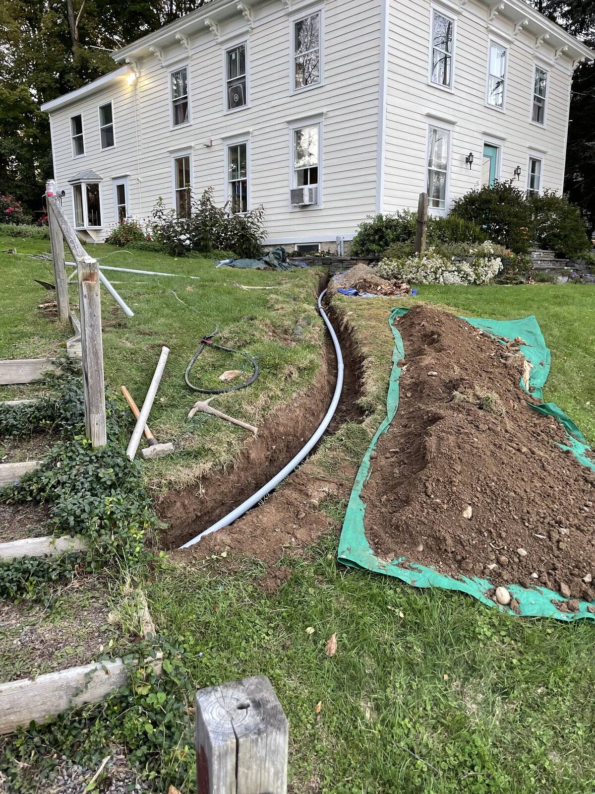

I went with the Chargepoint to get the 50 Amp rating. (Still looking for 6 gauge conductors that won’t cost more than the charger!) I do a lot of local trips checking on parents and shuttling kids and want to be able to add a few miles as quickly as possible. I also figured since the service to my garage sucked and had to run new, I may as well do it right. Then I can also keep the mobile charger that came with the car nice and neat in the “brunk”. ?
Maybe buying the BEV was just an excuse to re-power the garage and put some power tools in the loft. ?.

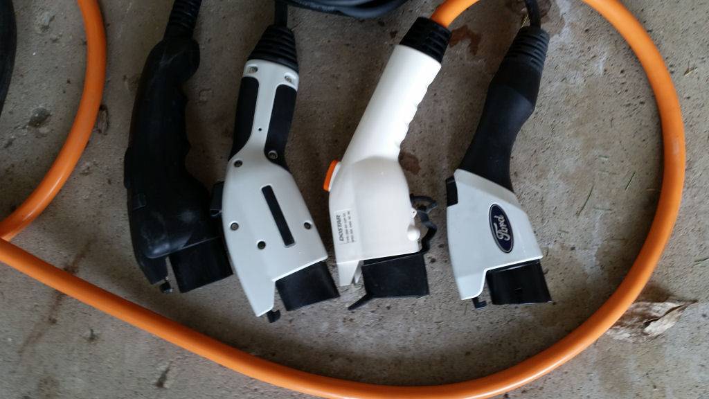

In addition: If anyone has any questions about anchient (in the EV world--circa 2013) Bosch/SPX, Clipper Creek, or JuiceBox chargers....fire away LOL.
