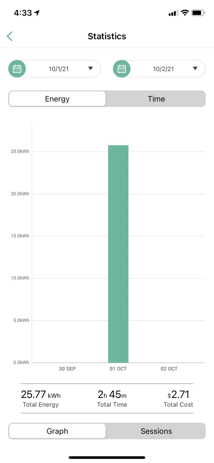

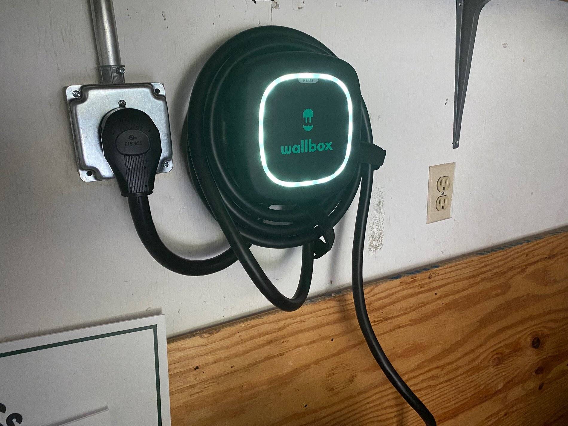

I'm happy with my Wallbox Pulsar Plus. A smart adjustable 6-40 amp, compact, indoor / outdoor Wi-Fi and Bluetooth EVSE. I especially appreciate the that it comes with a 25 ft cord. That will be handy for my wife's upcoming Rav4 Prime.
I had initially considered a hard-wired 48 amp unit, but I decided that if anything goes wrong with the plug in, I can unplug it and have the Ford Mobile Charger using the same outlet in less than a minute. 40amps is fast enough for my home needs.
Noise? Wallbox is completely silent. The only noise is the Mach-E internal charger hums quietly, and sometimes opens the shutters to run a cooling fan during charging. But it's not loud, you'd have to be within ten feet to even hear it indoors. Outdoors no one is going to notice.
