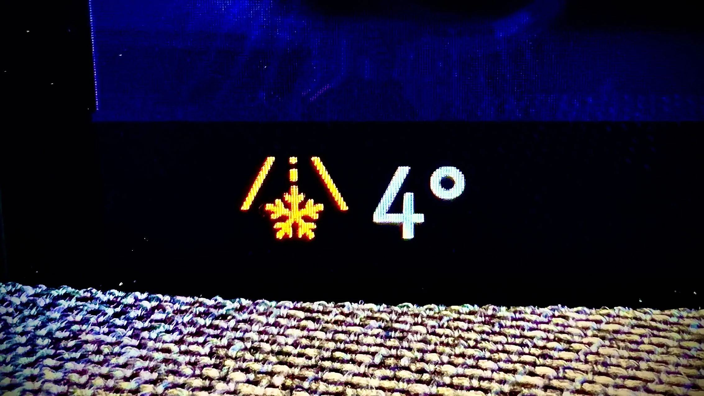

I get the icy snowflake symbol at anything below 4ºC in my Job 1 UK car - I feel special now :)

Are these icons concerning? I’ve never seen them before. Left the garage without preconditioning. 31F outside. I know the snowflake is exterior temp but the top two are new to me.
Wait the little orange snowflake on the road icon is exterior temperature? Should that show an actual, I don't know, numeric temperature? I thought it was some sort of fancy black ice indicator or something. That icon is nowhere to be found in the Quick Reference Guide or Supplemental Owner's Guide. It would be nice if they had a full legend of ALL icons the car can display.
The orange snowflake is just an icy road warning that will illuminate if the car detects an external temperature below 4ºC (39ºF) - or at least that’s how it’s configured on European models.
On US models the default is to show the compass direction next to this ice warning icon, whereas in the EU it shows the temperature. This can be changed if you have access to Forscan software and a suitable data cable to tweak the setting.

I saw that snowflake for the first time today. I figured it had to do with temp but didn't know the threshold. Thanks.

The orange snowflake just indicates the car has detected temperatures that icy roads may occur. I have it in my 2018 Outback, usually comes on around 35-40 F.

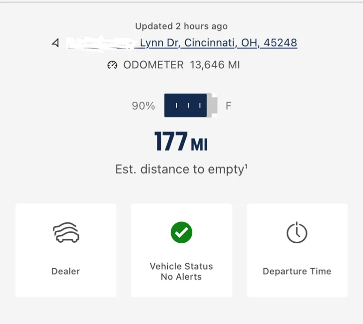

Charged my battery to 90% last night and it ended up with 177 miles. Doing the math, at 100% it would have been at 197 miles which is a 37% loss of distance on my LR battery. Anyone else seeing this much degradation?--garaged all night--25-35 degrees outside.
I have noticed some decrease. Usually I charge to 85% and I usually get 195-200 mi. This is for RWD Std range. Now I am getting 180 mi.

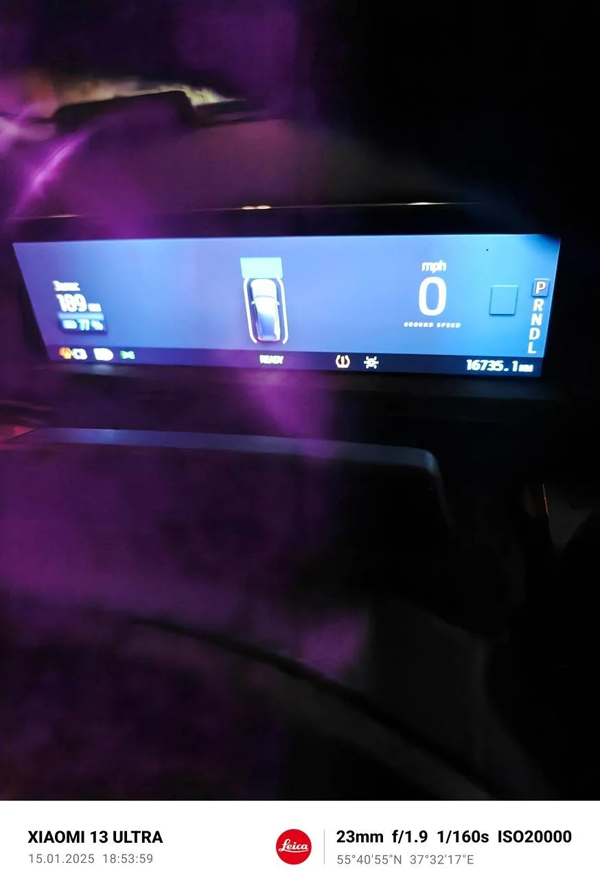

Hi guys! Could anyone please tell me what does this grey icon on the dashboard means the one on the right corner (didn't find anything about it in the manual)

Do you mean the low tire pressure icon or the driving assist system icon?
