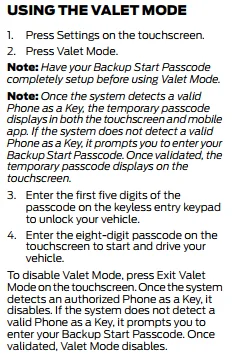

Are there any videos showing how it is supposed to look and behave?
I did a video but it ended up being too large so here are the exported frames that show how it worked for be (code is deleted after you leave valet mode)

I tried 'valet mode' .... got no numbers on screen, no numbers in the email it DID send me, and it locked the display with 3 'thinking' dots. After about 5 minutes I turned off the car. came back 15 minutes later and it seemed normal, but I dunno what happened to the valet code ?
kinda nervous about trying it again, but I'd like to make sure I know how to use it if I ever do have to valet park
I did try it again.... and it DID work this time... I got valet numbers.
I did notice that my MME did not lock doors when I turned off and exited 'as a valet'... because that's how I have it set for myself to avoid beeping in the garage. So, it may be a bit of a challenge in a valet situation to instruct how to lock, and then unlock the door with the code.
The big tip is to be SURE to take a picture of the code, and even better if the valet gets a picture of it as well, because the number does NOT show in the email that FordPass sends you.
