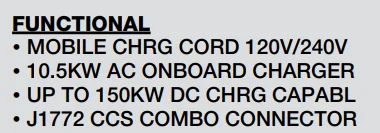

Ok searching local dealer (to me) inventory, I find a select's window sticker: (Note that this window sticker was reprinted 7/2)

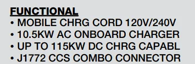

Another CA Route 1: (This one was reprinted 6/30)
Ford Mustang Mach-E What is the max kWh? 1625618365603
If its a typo you'd think that someone would have fixed it by now??

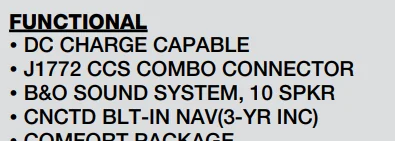

Yeah it doesn't show up on Premiums--I guess its a detail left off when the B&O sound system is listed. The premium also doesn't list the max DCFC (which is correct above):

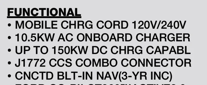

My window sticker says 10.5kW:
The only place I've seen a max listed...my window sticker !?
Does that 48 amp charger actually mean a 48 amp circuit (e.g. max continuous current of 80% of 48 amps or 38 amps--10.5kW is around 43 amps)?? (Yeah I know this has been beaten to death elsewhere in the forums LOL)
I’m guessing that 10.5kW is the Max the MME can charge, so they fitted it with an 11.5kW mac EVSE so charging is still at 10.5 after heat loses, etc.
Yeah I had considered that: 11.5kW is what goes into the car, but not necessarily the battery.

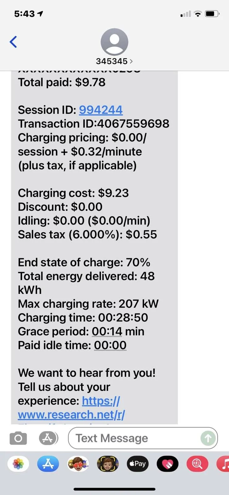

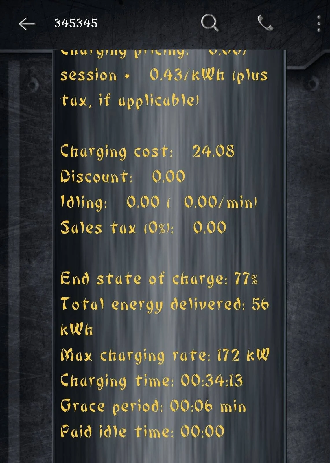

Just looked through my EA text receipts and found this one. Pretty impressive at 207kW, no idea how long it stayed there tho.

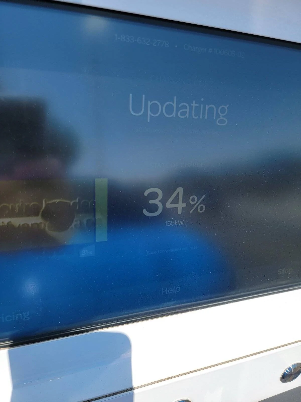

Yes, that's the info I was looking for. New to EV so not real clear on terminology just yet.
I could have sworn I saw above 150kW recently for a short period of time ?‍♂
Thanks
you did see it.
I think when I charge mine once it peak at near 160 KW but my AC was on plus charging losses and it dropped a little

Yeah I know, but I think it's a typo on the window sticker. The ford connected charger has to go on a 60A circuit, so it is indeed a "real" 48A draw.
