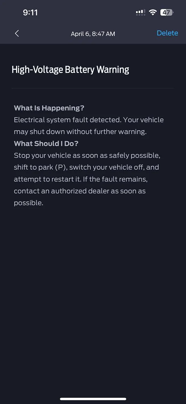

My 24 Premium just bricked with a high voltage battery failure. I have fewer than 10k miles on it. The initial diagnosis was “a high voltage fuse was blown.”
At the moment, “high voltage fuse blown,” communicated verbally, is the only information that I have. Which brings me to my question:
What diagnostic reports should I expect back on the high voltage battery?
I am concerned that the fuse was just doing its job, which is to prevent a problem from becoming a fire. I want the precipitating problem understood and I want confidence that it is understood. To get confidence, I want some logs or a diagnostic report.
The dealership said, “we don’t do that,” so I’m wondering how hard to call BS.

I got on the phone with Ford MoCo and they are saying that the dealer should provide some diagnostics, but I can see that I’m dealing with a system that is set up for ICE cars, not EVs.
They said it was a “multi point inspection” and they said the trouble will be on the invoice. I dunno… I don’t care about my brake pads (multi point) and I don’t care that they replaced the “fuse” or HVJB (invoice). I want to know that my battery is sound and won’t leave me stranded again.
I’m willing to be a squeaky wheel on this issue, because if I can’t trust the vehicle, I don’t want it. And I want to want the vehicle. But this stuff is discouraging.
