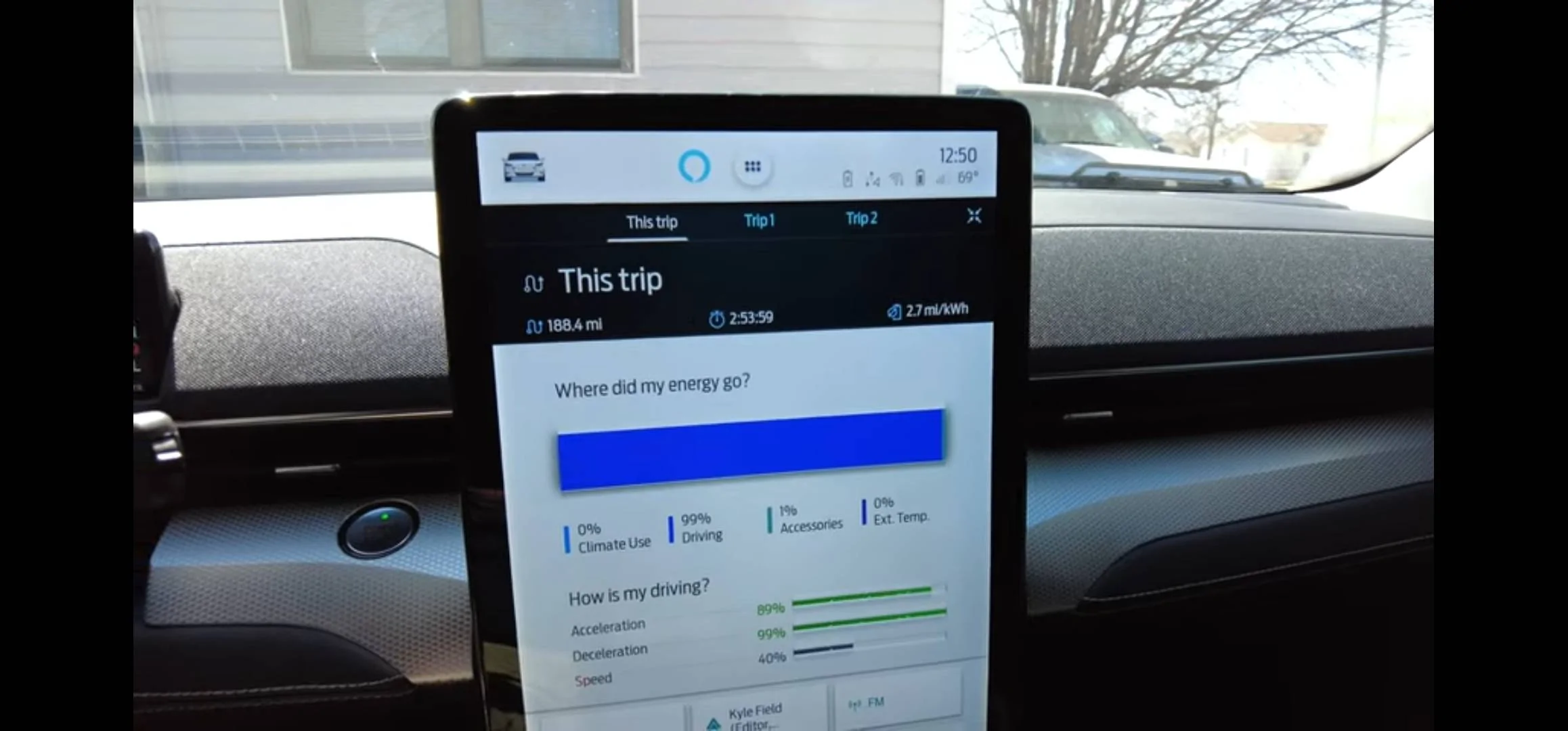

I understand that and most of my complaints have been figured out in this post. Those 3.3 kilowatt hours that I thought I was missing are not missing they are just below zero percent. In my opinion that's not usable range but whatever. Here's a screenshot from my range test where I went 100% to 0% and got 188 MI it was 69° and it shows that none of my power went to AC I'm just not getting very good efficiency out of the car.
Why is your speed rating 40%? That is a big clue to your problem. My speed ratings have been much, much higher than that and I speed. So you are doing something unusual to get 40%.
