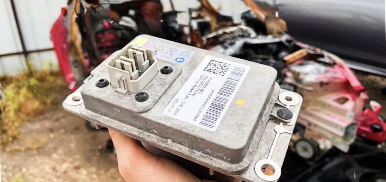

There is not a single EV that I know of that does not have a low voltage battery (LVB). You can't get around it for safety and startup reasons. You can start a DC/DC converter as soon as the car wakes up to cover electrical loads, but there will always be that initial startup period that requires low volt battery power to switch on high voltage and boot the DC/DC module. The DC/DC also cannot be continuously powered because the battery needs rest periods where there is zero load in order to sense cell capacities and perform cell balancing accurately. In summary, the inclusion of a LVB in EVs is an industry-wide practice that is necessary to meet high voltage safety requirements, not a cheapest/easiest solution for Ford.
The industry is moving towards smaller lithium LVBs. They have some advantages, but also some disadvantages compared to lead acid batteries (such as being more susceptible to extreme cold). Lithium batteries still need periodic replacement every 5-10 years, and cost more to replace.
Below is Tesla's 16V lithium LVB, you can see it's significantly smaller than our battery (6.9 Ah/99 Wh). There is not much room for error with power management, if the high voltage shuts down you only have minutes until everything goes dead.
So, I will make a prediction. With 10 years, many EVs will not have a low voltage battery. If I had to guess, I would guess that the Chinese will figure out a good way to do this and the American manufacturers will play catch up. Watch this space!!
