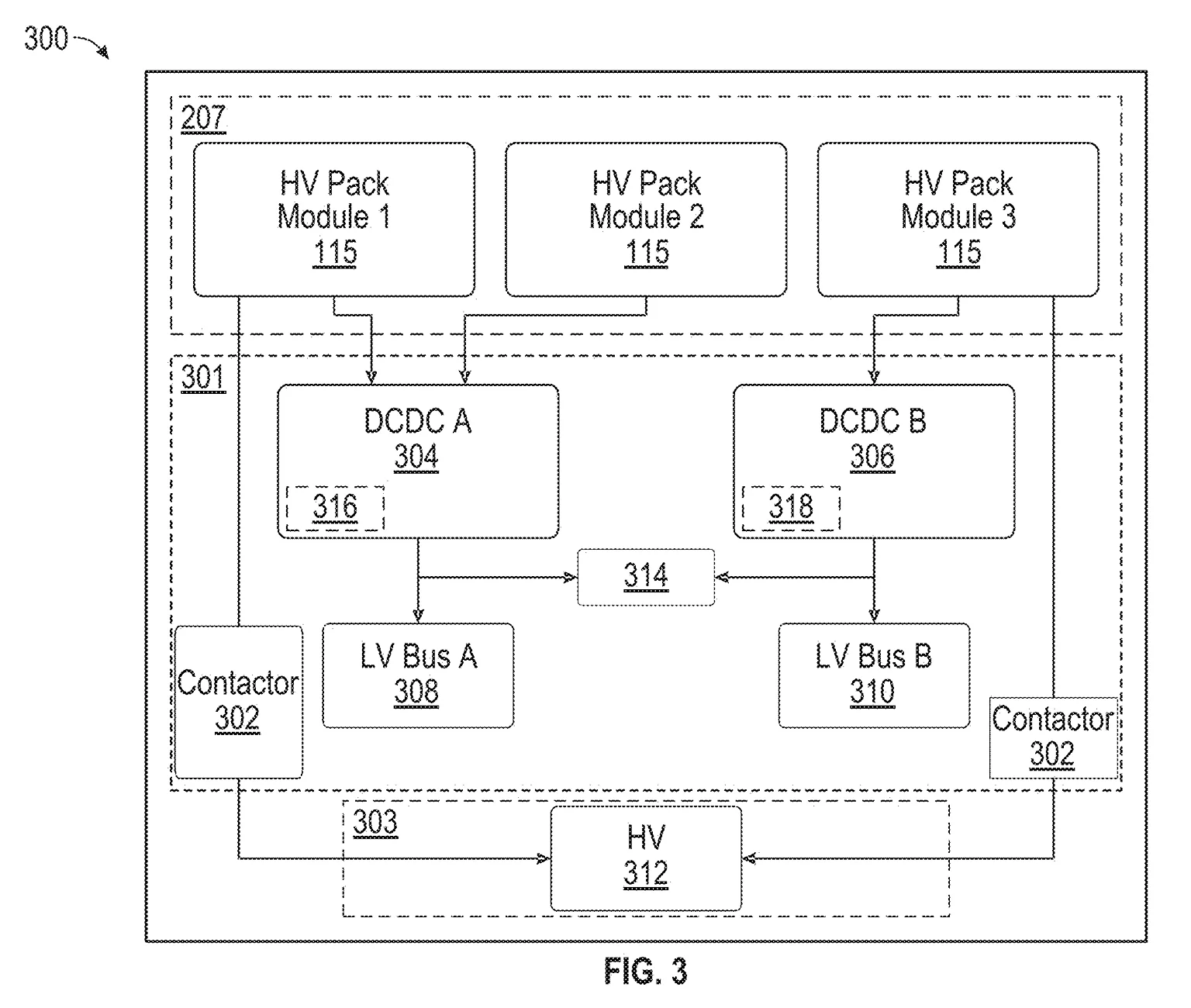

Rivian has a patent application to remove the 12V battery. Based on the description, it sounds more expensive than a simple 12V AGM or lithium battery. That's probably why it has not actually been done yet.
Key Details from the Patent (US20250296474A1)
Title: Low Voltage Battery-Less Architecture for Electric Vehicles.
Assignee: Rivian IP Holdings LLC.
Inventors: Kyle Lobo, Sanjeewa Keven Sugatapala, Muhammad Mobeen Mahmood, Joseph Daniel Himmelheber, Baojin Wang, Brandon Louis Fennema, and Todd Adams Putnam.
Filing Date: June 2, 2025 (this is a continuation application with priority claiming earlier filings back to at least February 21, 2024).
Publication Date: September 25, 2025.
Abstract Summary: The architecture supplies both high voltage (hundreds of volts for propulsion) and low voltage (e.g., 12-15V or 40-60V for auxiliary systems) from a shared high-voltage energy volume, without any separate low-voltage battery. It uses modular, serviceable enclosures that can attach to various battery pack frames, incorporating power electronics for conversion and distribution.
How It Works
The system taps into the high-voltage battery pack (which consists of multiple battery modules or subassemblies) to generate low-voltage power. Here's a breakdown:
Core Mechanism: Direct-current-to-direct-current (DC-DC) converters are connected "pre-contactor" (before the main high-voltage switches) to specific subsets of battery cells or modules within the high-voltage pack. These converters step down the high voltage to low voltage without needing a dedicated 12V battery. For example:
One DC-DC converter might draw from one group of battery modules, while another draws from a different group, ensuring electrical isolation between them.
This setup allows the low-voltage system to remain powered even if the high-voltage contactors open (e.g., for safety reasons), as the converters pull unswitched power directly from the battery cells.
Redundancy and Load Balancing: Multiple DC-DC converters (at least two) provide redundant low-voltage buses. A switching mechanism can connect these buses across converters to balance loads between battery subassemblies, preventing uneven drain. Pyrofuses (pyrotechnic disconnects) allow selective isolation of faulty sections without cutting off all low-voltage power.
Modular Design: The power electronics are housed in a separate, attachable enclosure made from insulating materials with conductive layers for EMI/EMC protection. This module connects to the battery pack frame (e.g., under a rear seat) and provides accessible ports for high-voltage (to drive units) and low-voltage (to vehicle harnesses) outputs. It's compatible with different battery sizes and chemistries.
Low-Voltage Applications: The derived 12V (or similar) powers non-propulsion components like lights (headlamps, turn indicators, brake lamps), actuators (doors, windows, seats, mirrors), sensors, HVAC, audio systems, wipers, defrosters, radar, charging ports, and more. It also supports zone controllers for different vehicle areas (e.g., rear zone).
Benefits and Operation: In normal use, high voltage powers the motors while low voltage runs auxiliaries simultaneously from the same battery source. If high voltage is disconnected (e.g., via contactors), low voltage continues uninterrupted. The vehicle operates entirely without a standalone low-voltage battery, reducing complexity and potential failure points.

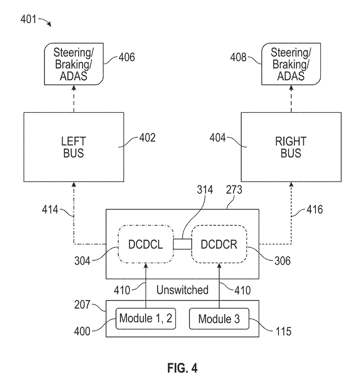

That’s interesting, but I don’t know how you’d prevent uneven discharge of the cells in the battery pack unless there are perhaps two DC/DC converters connected to half of the battery each, and they periodically alternate back and forth like wing fuel tanks on an airplane to balance discharge. If one failed this would create a bad situation where only half the cells in the pack are drained, unless you have a switching matrix to change sides of the pack. That would be difficult or impossible to do without a 12V interruption. If one DC/DC suddenly failed I think that would still create a stop safely now situation.
It’s an interesting idea if you absolutely have to eliminate a 12 battery, but it is definitely more complex and more expensive than having one. Once you start getting into the possible failure, modes, I think you’d really need to have at least 3x DC/DC converters to make it safe.
EDIT: I found the figures. In the patent two DCDC (A and B) are fed from three separate cell modules, and 314 is a bus cross tie that allows DCDC A to power LV bus B and vice versa as needed to balance discharge on the HV pack modules with unequal LV bus loads. The bus cross tie would have to periodically swap the LV busses back and forth to ensure the cells all stay within 5% SoC of each other.
If a DCDC failed, you would have a limited amount of time to drive the car until the cells got too far out of balance, basically this would force a service visit to replace the failed DCDC.
The key thing that also makes this work is a zonal LV architecture, basically two separate body control modules that can power separate areas of the car or provide redundancies (such as steering/braking/ADAS as illustrated).
Ford Mustang Mach-E Why do we have a 12V battery? US_2025296474_A1_Fig3
Ford Mustang Mach-E Why do we have a 12V battery? US_2025296474_A1_Fig4
