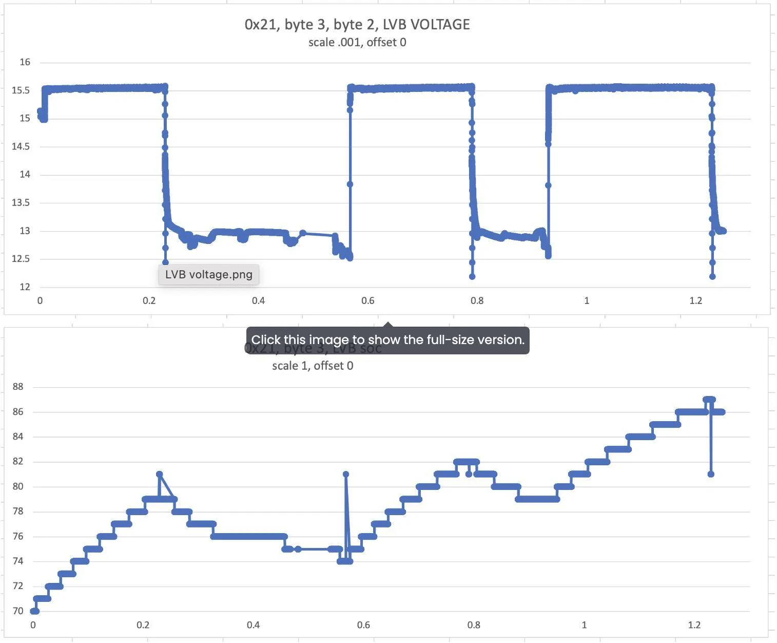

... I wasn't aware that plug-in hybrids are having 12v battery problems when they are driven mainly on short commutes since the battery does not get charged.
Three short drives (8 miles x 2, then 7 miles) yesterday showing the battery being charged (albeit not at 150A). Voltage top, 12V LVB soc bottom. It was a chilly 16F.
