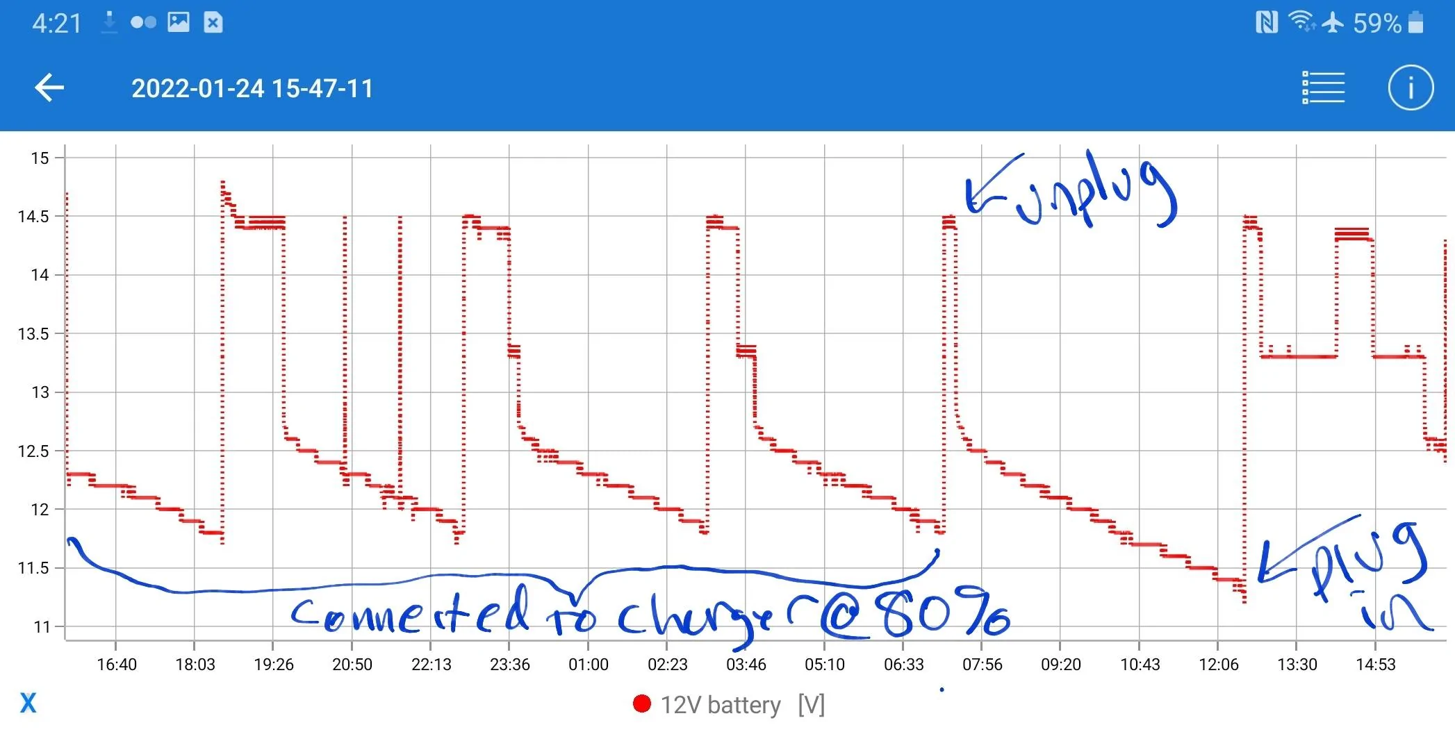

I don't think this will work. I connected a bluetooth OBDII reader and it drained my battery down to 10% before I plugged it in and it recovered.
I was monitoring the LVB to see what would happen, and it seems that when the car is plugged in, it charges the LVB when it gets down to 40%. When it is not plugged in, it looks like it did a small charge at 10% but it really didn't do much of anything until I plugged it in.
So if you leave your car unplugged outside in the cold for a long time, I can see how the 12V could be damaged over time. However, I did notice that when the car is unplugged, it goes into a deep sleep (as most everyone knows) and unless you have something draining the battery (like my OBDII scanner), it should last for a long time unplugged.
It seems to me that people experiencing low LVB must have a problem with the car, assuming there isn't anything draining the battery like I did in my test (such as a heating blanket. ;-)).

My car did not maintain the battery as you expected when disconnected from the charger. It didn't start maintaining the battery until I connected it to a charger. It is possible it would have maintained it at 11.3V, but I am not ready to take one for the team and test that out. For sure my test demonstrated the battery is not maintained the same way when disconnected from a charger
I think in normal situations the battery would not drain hardly at all when sleeping, so my test really simulates a load which should be a lot less than a heating blanket.
I go back to my previous statement: if your battery is dying, there is something wrong. It should never happen when plugged in even with a load (like a heating blanket). Unplugged there should not be a sufficient load to kill it, unless you have something attached.

Excellent test. What is your 12V standby drain average (quiescent) after obd2 dongle was connected so long? And normally without obd2 dongle connected overnight?
If you look at the time scale I only let it sit overnight with the charger attached, and a few hours in the morning with the charger not attached. I don't know how much current the OBDII scanner pulled, but it has to be pretty light. I am using the scanner to capture the readings so I cannot compare with and without. But when the charger was unplugged I got a "draining 12V battery error" when I started the car.

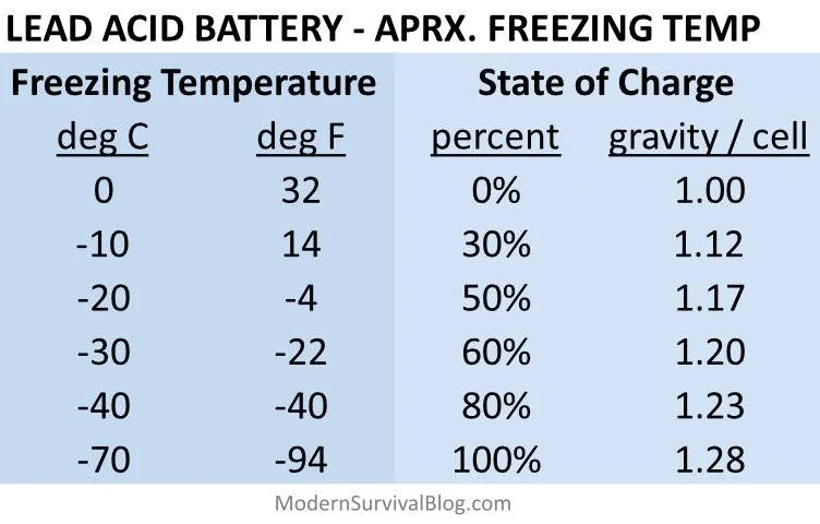

12V will freeze/die plugged in also and you also think that is at around 40% SOC? My experience is it will drain a new battery at -28C plugged in. Plugged in will not help here. Why is it dropping from 90% to 40% so fast is a question? There has to be a large phantom drain here somewhere, something is sticking and quickly depleting the 12V now it is cold. It happens in hours (quick) not days. You could be shopping come out and it is dead. It could be so dead that you can not even get the doors open again to remove your child.
My car just has not worked well so far this winter starting early December. Have had similar weird behave as others note above with errors and driving it with no regen no awd no mode selection no cruise etc. and then sometimes it just plain won't go into gear. 12V died twice so far "this" winter while plugged in. My car is certainly not something you can depend on during this season. Ran well all summer then the temperature started going down and now after cold for a bit it's a bit of a mess. Definitely temperature related and therefore can not be explained by the behavior of this vehicle above 32F. Need to try at -16F.
Cars.com
“A 100 percent fully charged battery will not freeze until approximately minus 76 degrees Fahrenheit. A fully discharged battery can freeze at or around 32 degrees,” Kimbrough said in a telephone interview. The difference between a fully charged and discharged 12-volt battery is not that big."
Will a 12V freezes at -16F (-27C) at 40% soc? Above freezing temperature behavior of this car is not the problem here. What it should do and is not doing when it gets cold is.

Two here have agreed that when it is plugged in it charges the battery when it gets to a 40% SOC. @mkhuffman above and @louibluey Here? Joe is not as detailed ;). When not plugged in it goes to even a lower soc from what I understand. Both a large drain and poor logic?
Ford Mustang Mach-E 12v battery problem can have serious consequences lead-acid-battery-freezing-temperatur
Edit: -32C this morning 91% soc on the 12V and all good at 7am here?
this chart shows expected wake-n-charge behavior while plugged in.....
....and 'bad' behavior when not plugged in; MME should not have allowed the LVB voltage to drop below 11.9. So, I'd say this chart is exactly what is needed to show your Dealer and @Ford Motor Company to request a check on any related modules updates that may be required.

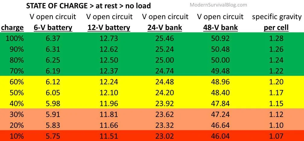

Mine sits better when unplugged and I have never got a charging fault, Hybrid battery positive contactor - circuit stuck open or a dead 12V when parked and not plugged in. Of course it is a lot warmer when it is not plugged in and always plugged in when below freezing.
You also vote that it goes to 40% state of charge before it maintains the 12V.
Ford Mustang Mach-E 12v battery problem can have serious consequences battery-state-of-charge-chart_v2
What temperature would the 12V freeze at when at 40% soc around 9F (-15C)? Thinking we may not have the full picture yet and it may have a minimum 40% soc value when warm but monitor the temperature senor and adjust based on temperature also? Have not seen a lot of brilliant software in there yet but possible. When my 12V is at 90% soc I never have problems. From what I have seen it is a problem with something being triggered on my MME that sucks the 12V down fast.
