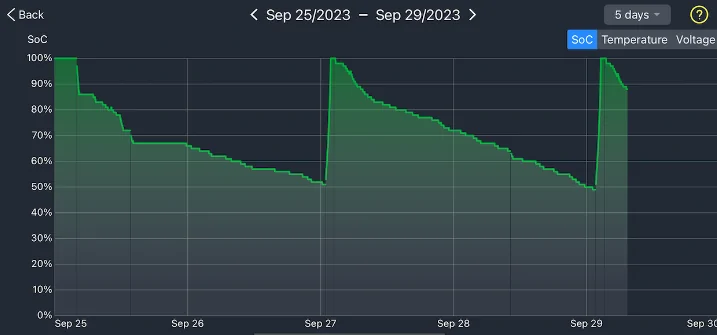

Add 3. If your 12v battery drops below 50% it will charge from the HVB always (plugged in, not plugged in it will do this otherwise the car will be dead after 5-6 days.)
Here is the chart from my independent monitor while not plugged and not used over several days. I think there have been several updates to the charge parameters and deep sleep parameters over the last 18 months so the version you are on might vary slightly for when it charges and when it goes into deep sleep. If will maintain the 12v battery in all versions.
Ford Mustang Mach-E 12 Volt battery? 1706027248811
It takes about an hour to charge the 12v from 50% to 100%. No noticeable drop in HVB SOC.

Hi, I'm the one that started this thread. From the graph above it amazes me that the 12V battery would go down so fast.

Yes, when I did this test, my 12v battery was weak. That is why I installed the monitor to track it. It should probably take 4-6 days for the cycle that shows in 2 days in my graph. My battery has been replaced since then.
In your case, for 2-2.5 months, you will likely be ok regardless of which way you do it. If it were mine, I would have the SOC at 30-50%, disconnect the 12v battery (negative terminal), and connect a 12v AGM battery maintainer to the LVB. This will keep the 12v battery in good health and store the HVB in the optimal state for longevity.
The difference is minor however if you leave it plugged in, set the SOC to 50%. This will maintain the HVB without over-energizing it unnecessarily. Adding a 12v AGM battery maintainer to the LVB will keep it from cycling as shown in my graph. This will keep it healthier and overall less wear and tear on it. A 3-10amp maintainer should be adequate for long periods of inactivity. I use a 10 amp.
