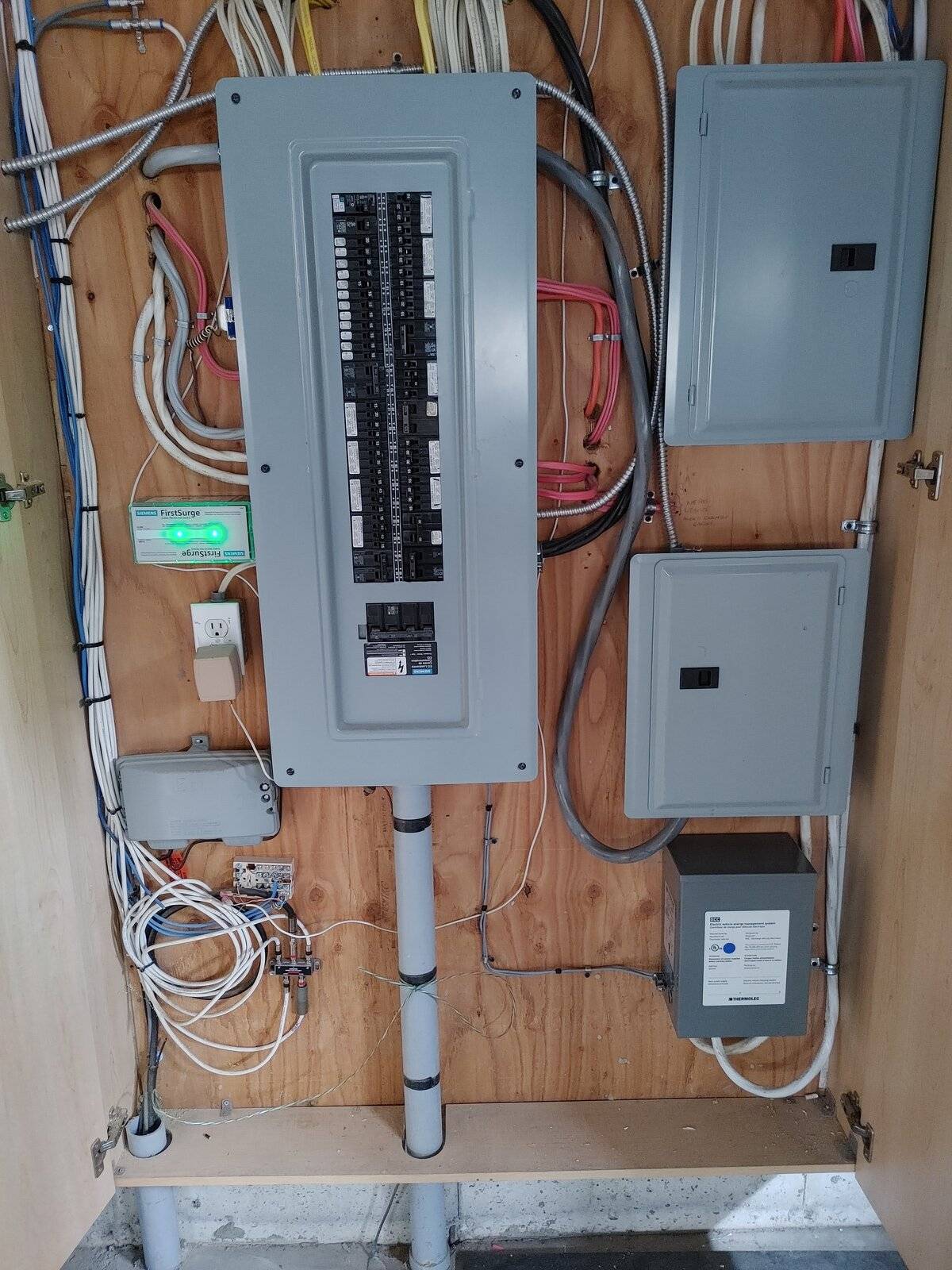

Getting a Homeflex installed (new hardwired circuit) on June 3 prior to my Mach-E arriving. Have a 200 amp supply but still not sure whether remaining capacity will support 40 amp charging on a 50 amp breaker during the day, or whether would be safer to limit it to 32 amp charging. Wondering if a possible strategy would be to charge between 11 pm and 7am at 40 amp rate using the Homeflex (when there will only be home 240v AC competing in the summer). The other 240 circuits (range, dryer) would not be in use then.
Thinking that the only time I would need to charge during the day would be to precondition/preheat in winter before leaving. Wondering if connecting the Mobile charger at 110 volt would be enough just for this preconditioning. Does this seem reasonable to avoid having to limit the Homeflex circuit to a 40 amp breaker and 32 amp draw?
