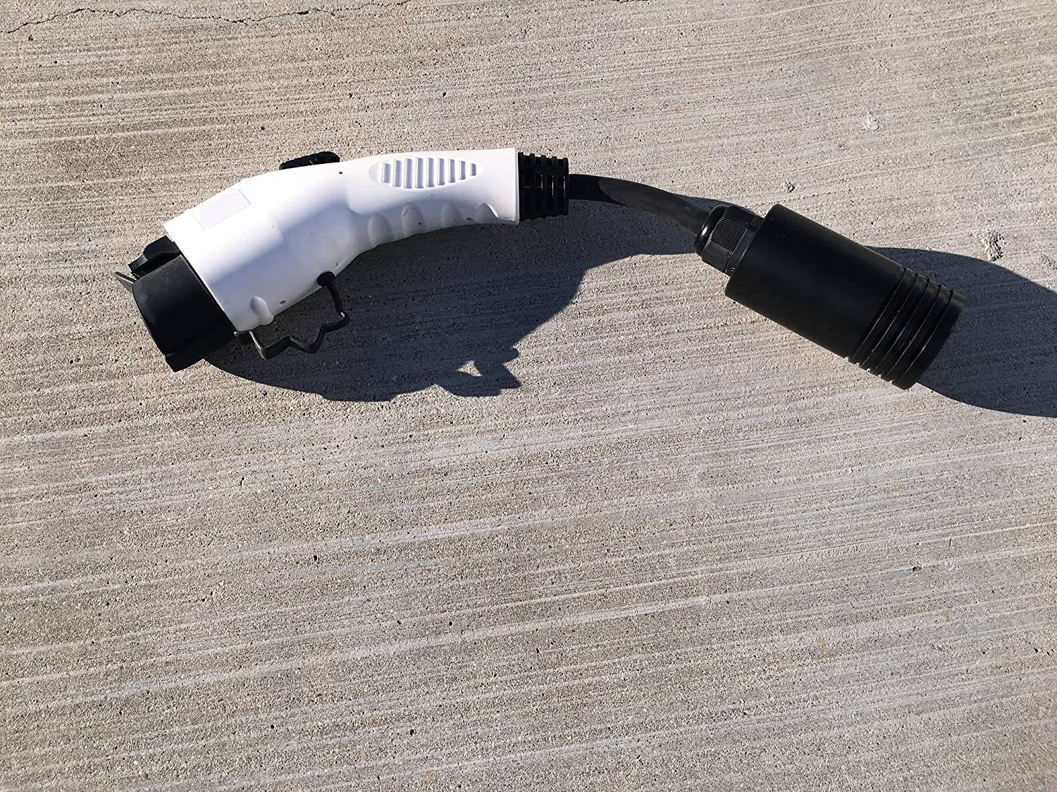

I have the Tesla Tap adaptor for my CMax Energi . It does work.:
With this adapter cable you can charge your non-Tesla EV on a Tesla Destination, UMC, or Wall Connector charger.
The adapter has a special circuit that allows it to work on any current Tesla charger including Destination Chargers.
This is the link: http://www.umc-j1772.com/index.php?route=product/product&product_id=50
