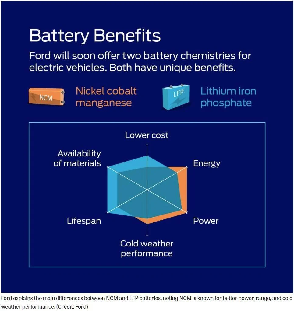

Batteries weigh more and much less range.
There are many differences, but the most relevant cons are lower power density (thus you need larger battery), lower voltage, and their range drops faster in cold weather.

All standard range packs built from now on (>2023.5) will be LFP. Which will be available in Select and Premium trims.

If you want the battery to last that long, try to keep it below 70% most of the time. Be aware that the battery could lose up to 40% range in 15 years due to calendar aging of the cells. This effect is much less in LFP cells, which is a better choice for long-term ownership.

I would love to trade for the LFP version if I could (that train has left with what I paid/less credits now).
You can have it charged always to 100% and folks feel LFP is a safer chemistry in general (me included).
Kinda depends though.
The LFP Mach E starts with less range.
So while it may lose less range 12 years from now…… it starts with significantly less.
If range concerned, probably better off with the long range model anyways.
If buying used and only looking at SR models, I could understand wanting the LFP battery.
