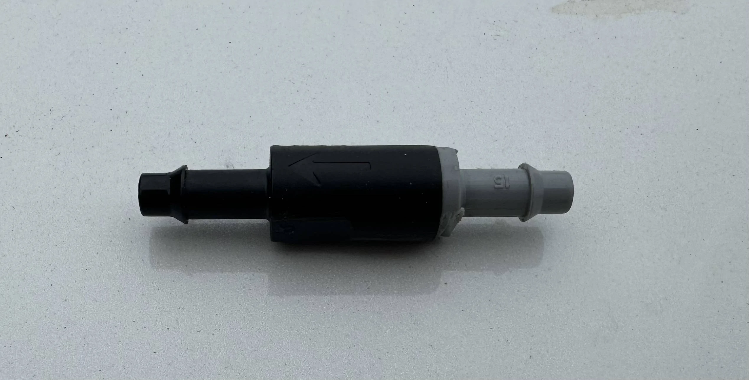

My windshield fluid nozzles recently started showing symptoms of an enlarged prostate, producing but a mere trickle of washer fluid that barely hit the bottom of the windshield. After taking off all the plastic panels and even removing the frunk, I was finally able to narrow it down to what looks like a one-way valve that sits right behind the transition piece on the plastic panel the wipers are surrounded by (I only loosened that by removing all metal clips; to get to it, you only need to remove the first panel in the sequence under the hood).
Ford Mustang Mach-E Windshield fluid one-way valve failure 7F572B8E-78E0-4E59-987A-038F1E1EDAFD
The valve isn’t completely blocked but it may well be that something got stuck in it. Since it’s one way, it seems hard to clean out. For now, I have just replaced it with a micro sprinkler hose junction, since I am going on a trip tomorrow and it’ll be wet.
Has anyone run into the same issue? Where can I get a replacement? (Don’t want to deal with the hassle of taking the car in for a warranty repair)

OK, I should have googled this before posting, but it’s called a windshield washer check valve and has apparently been an issue in other Ford models, especially in regions where it gets cold. Folks just drill it out and move on with their lives… wondering if the only drawback is that the nozzles won’t spray immediately because the fluid runs back into the container!?

So mine is clogged My husband removed it and it’s soaking. But should I get a new one ?​

Good timing! the very same thing happened to me yesterday. The driver side squirter is barely hitting the windshield. Can that "prostate thing" be completely removed?

Mine from tiny spray to no spray. My husband took the check valve out and it is soaking in vinegar. He connected the hose and front washer works again. I also ordered a part from Amazon. 85321-26020
Some sellers say it fits mache and others don’t. I ordered one that said it fits. It’s a Toyota part. Couldn’t find the ford part number.
