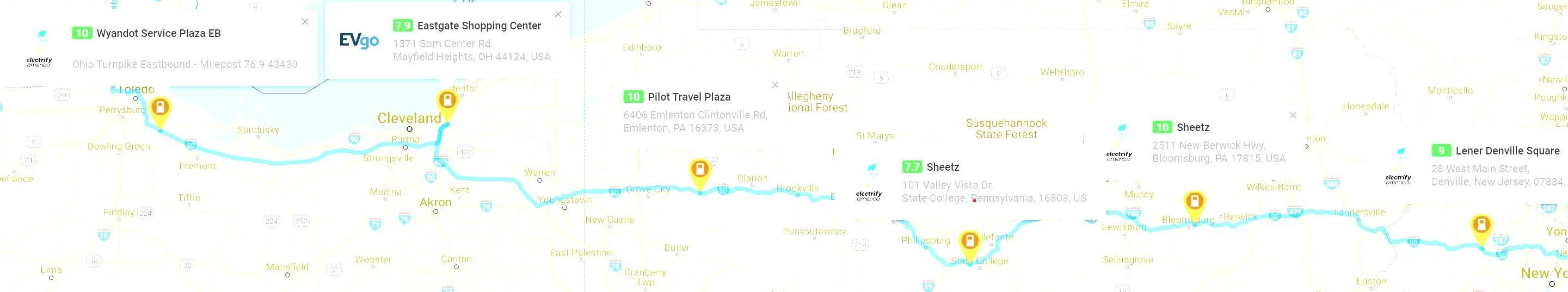

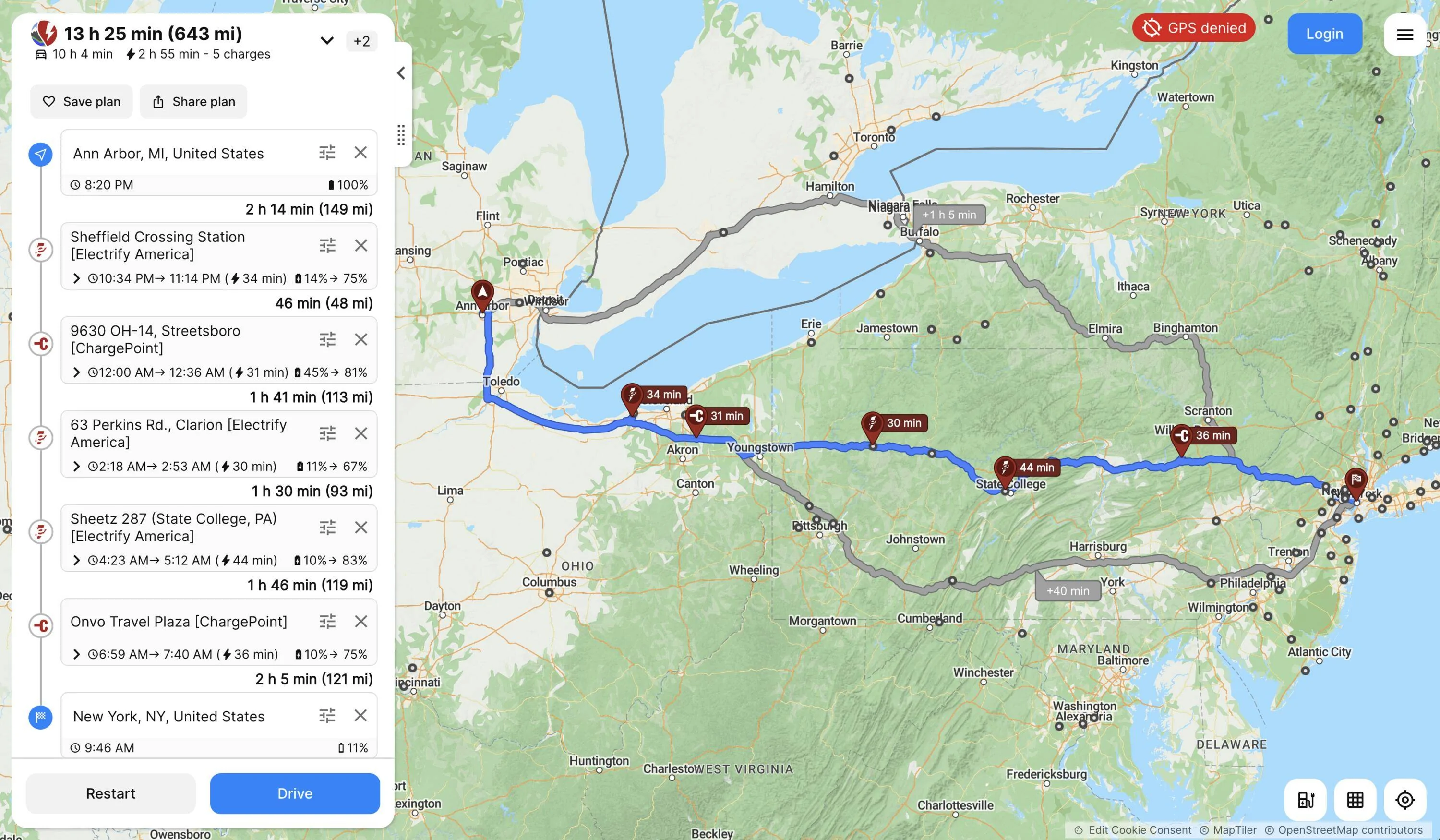

FYI you can click the X by a charger in the route plan to skip it. I'd recommend you do that for the Sheetz charger. You'll have to compensate by making more stops, but you're not going to be able to go more than about 125 miles between chargers.
This is what I got after excluding Sheetz:

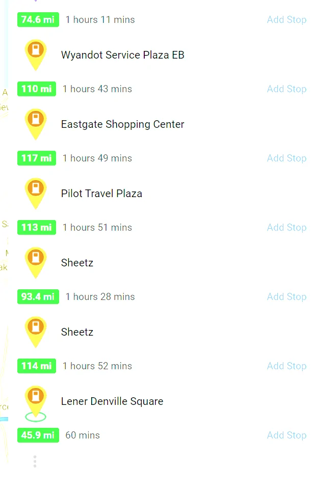

Yeah I've been making adjustments with Plugshare manually since whatever Plugshare data source they publish that ABRP and the Ford trip planner uses hasn't picked it up yet. Been meaning to dig into the data sources there a bit.
120mi splits puts this at a 2.49kWh/mi average assuming staying strictly between 10 and 80%, which seems slightly aggressive but perhaps also not too hard to achieve with some smart DCFC preconditioning.

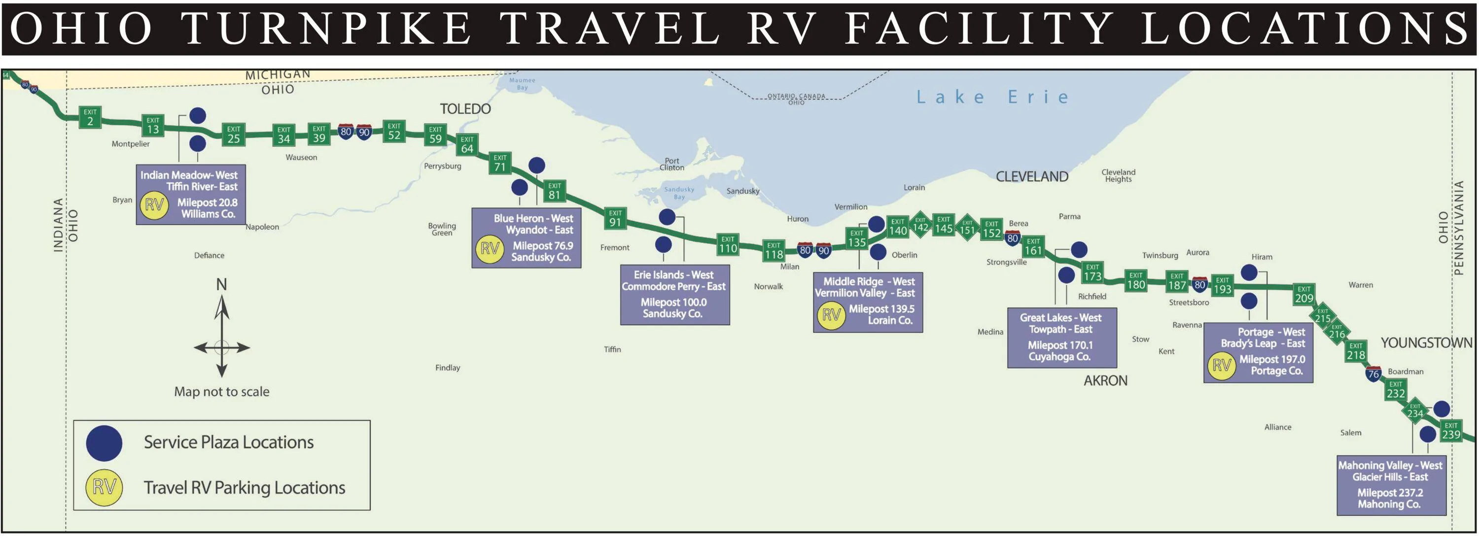

If all else fails and you're desperate there are RV hookups that should allow your mobile charger to get you some much needed voltage.
That Sheetz that's closed was a lifeline to me . Now just hoping the warm weather allows me to get a round trip in
