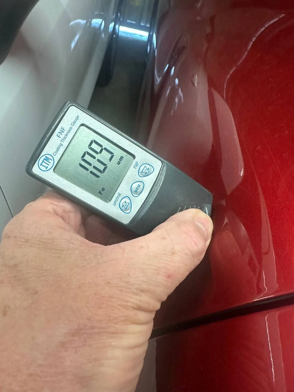

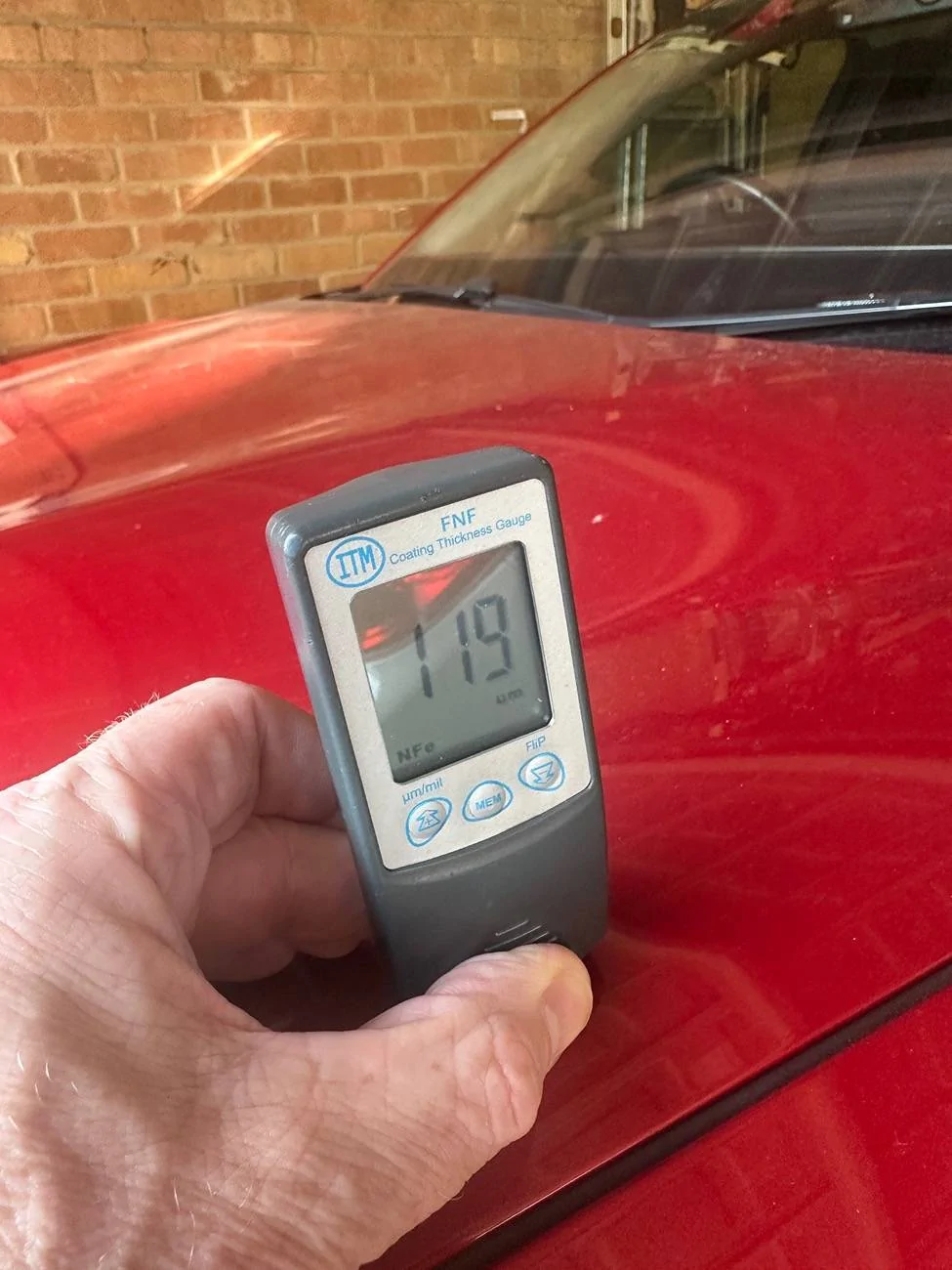

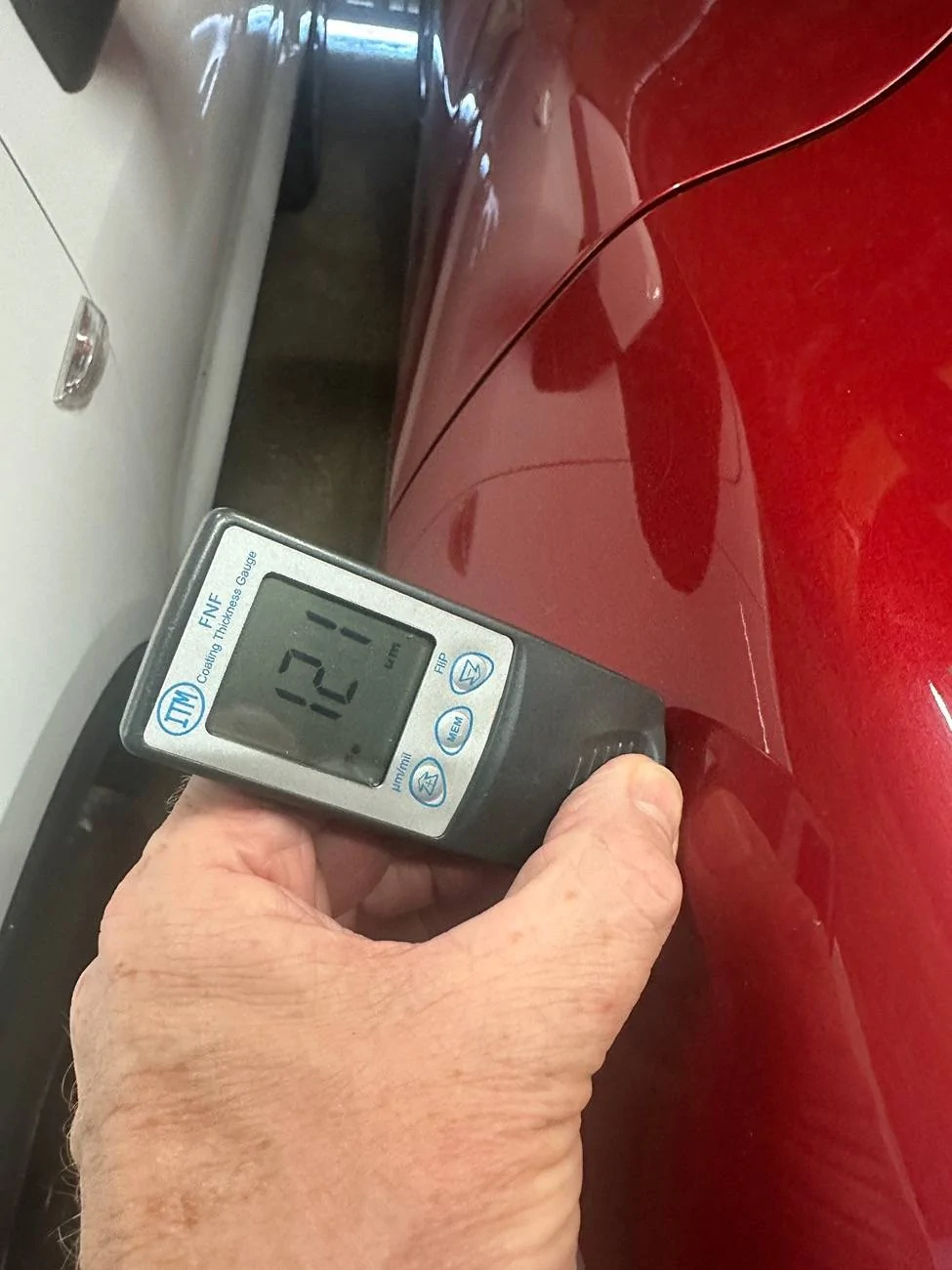

Paint & coating depth reader on door & rear wing (Fe) & bonnet (None Fe)
Cool! I never knew there was such a thing. I wonder how it works?

Some kind of electronic wizardry - had one which measured the coating depths on plastic parts but that cost about £1500 and stayed with the business I sold.
That’s how you can tell if the body had any repainted panels.
If you have a trained eye you don’t need one of those for that purpose, I only use it to illustrate in reports that I found parts & panels which have been repaired or, at least, repainted.
