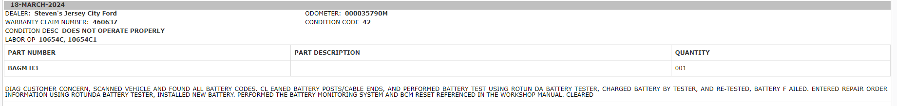

Tech notes say they did, but if they did, they did not do it with FDRS. On my truck, there is a way to reset the BMS by putting in accessory mode, flashing high beams 5 times and tapping the brake 3 times. If these cars can have the BMS reset the same way, then maybe they did do it and that is why vehicle history does not show it. It's impossible to tell.
I don’t remember 100% the procedure off the top of my head, but yes, Mach E can be reset doing something like what you just said.
That's exactly what I did: turn on in accessory mode (don't touch brake), flash 5 times, tap brake 3 times.
