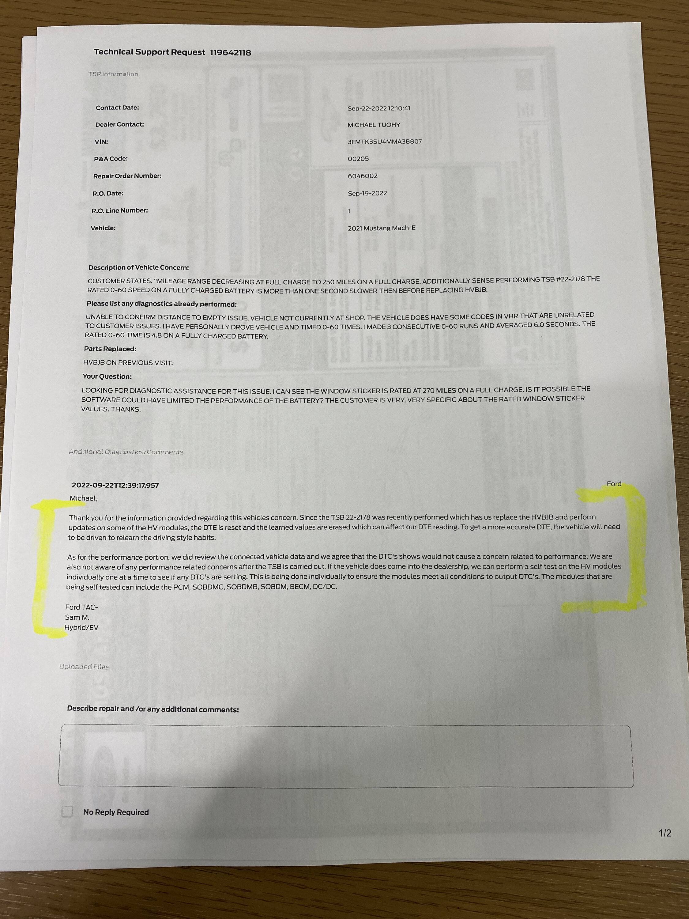

So my range is now 251 at 100%. When I bought the car, I got between 300-312. After winter, It maxed at 286. Then I got the HVB error and the hardware fix. Now I am at 251, slower acceleration and top speed is now 4mph miles slower. My consistant usage is 3.1 KWPH at 60 mph, no a/c or heat on. It goes in Monday for further diagnosis.

This is the engineers response. Waiting for the dealer to schedule the battery check.
