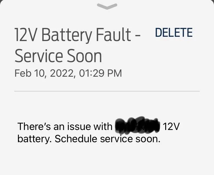

So crazy. Got the same message today - while my car is being ceramic coated!!! Glad to hear it seems to be a fluke, and not a major malfunction. But isn't it weird it's happened to several of us while the car is being ceramic coated? My guy told me they did not disconnect the 12v and that it started fine.
I just got the same message, too. Very disconcerting, just as I was getting ready to sell my ICE car! The MME started right up so who knows what that’s all about. Is there somewhere on the car’s control screen that indiates 12V battery strength?
No, but you can download either the Android or iOS widget and both of those will show you the battery voltage. I got this once on my Premium and then just never saw it again.
