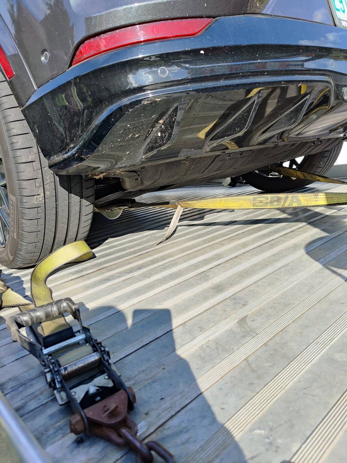

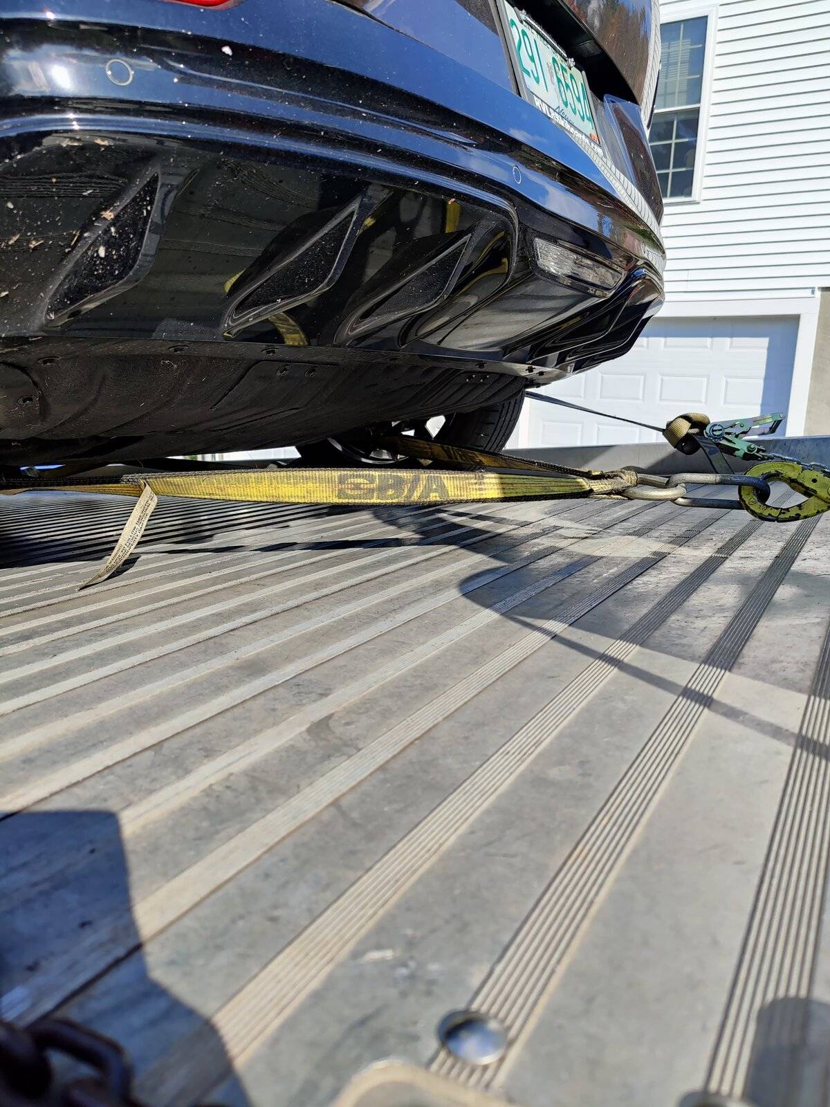

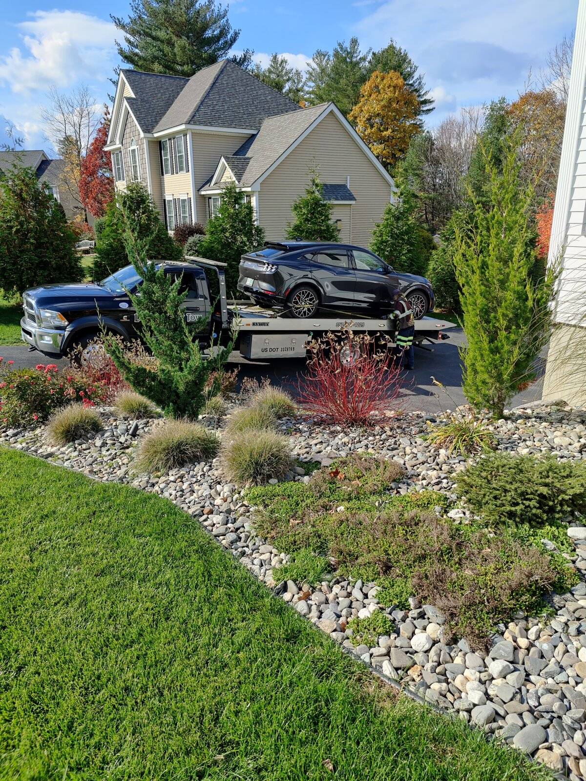

Here's how they hooked up to tow me:
He put the padded straps in to the bottom control arms.
