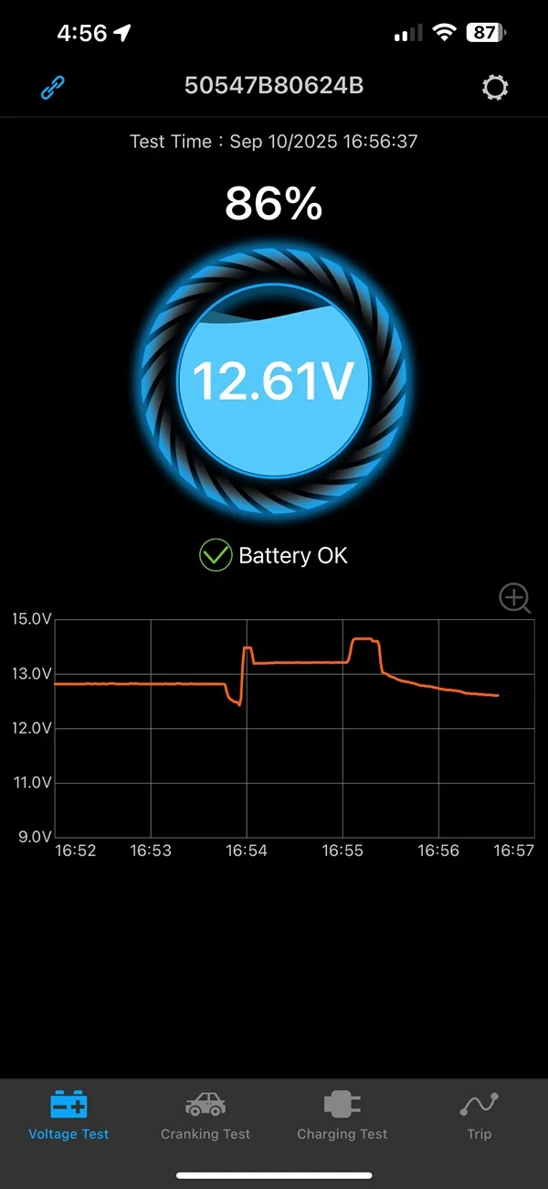

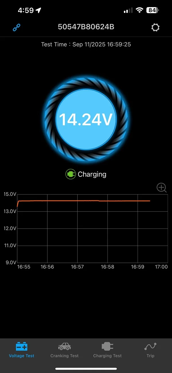

Are you sure you had the car fully turned on in the first time? Maybe you had it in accessory mode by accident? If the car is fully turned on (READY light) and shut off, it should work regardless of whether it was driven beforehand.
As pointed out above, dealers are now required to complete the software verification step that exists in FDRS. That should mean if the recall disappears from FordPass, it was correctly applied. Ford will not pay the dealers for the recall work unless it was verified complete.
I just went to re-test because this made me curious as well. Powered on (made sure it was on-on, not accessory mode) and then off a minute later. Once off, the 12V voltage went to 14.25V, as expected. In the morning I'll test accessory mode to see what the voltage graph looks like because now I'm wondering if I didn't have it in accessory mode by accident as you suggest. Would certainly explain things.

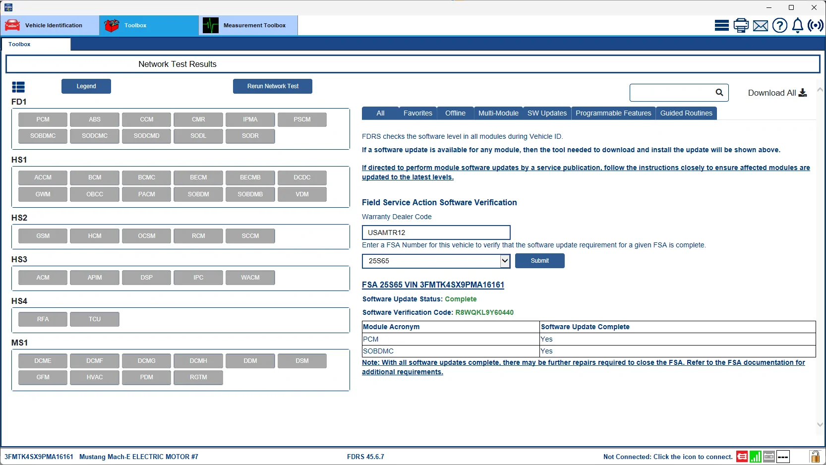

So day 3 after the update and Ford Pass still says the recall is incomplete.
I talked with my dealer to see if they'd complete it for me and they have to send a mobile unit out to "bless" the FDRS result in Oasis. So I guess you can only officially complete it in Oasis and not FDRS. Probably so they get an official confirmation it's actually done, even though FDRS says it is.
Did you submit your FSA verification approval code on your OWS Warranty Claim?
...I didn't think so. Since neither you nor I are working for a Ford Dealer Service department, we don't do that sort of thing. So the recall won't get cleared and we won't get credit for it. But your actual servicing dealer can the next time your car is in the shop for something. So running the FSA verification will get you a code.....but you have no place to put it to clear the recall from the system.
Ford Mustang Mach-E 12V Recall (25S65) Software Released FSA_submission
BUT.....if your dealer service tech were to fire up a FDRS laptop...enter your VIN...and run the FSA verification check from the comfort of their office, they'd end up with the same verification code you did.....without even being connected to your car. I know this because I've done it.
Ford Mustang Mach-E 12V Recall (25S65) Software Released 25S65_FSA_Verification-9-Sep-25_
It just checks that the required versions of the module software are what's installed currently.
So you could send them the screen grab from your FDRS, or you could have them run it themselves and end up with the same code. They may not be aware that this is even possible.

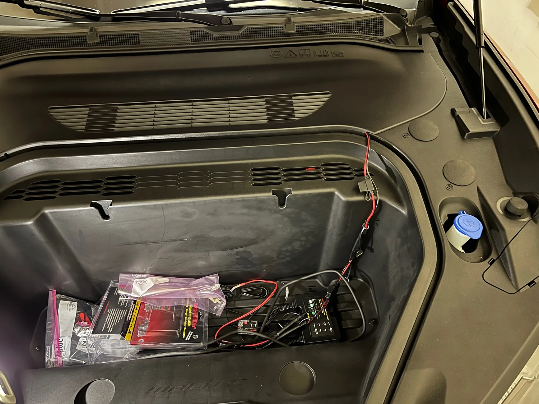

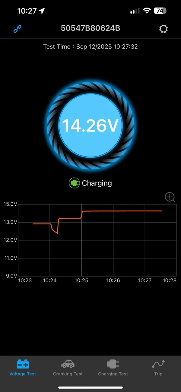

Tested the behavior of accessory mode this morning and the mystery deepens. Even an on-off in accessory mode (driver door left open, if it matters) appears to trigger the post-recall behavior of powering the 12V system at 14.25V after shutoff. Best guess at this point was the software update was present but not active yet?
Ford Mustang Mach-E 12V Recall (25S65) Software Released IMG_2413
Door opened at 10:24, shortly followed by accessory mode on, then off at 10:25.
For my original failed test I'm pretty sure it was a full power on and not accessory mode because I had the original 12V battery the car came with die on me at a really inopportune time earlier this year and strand me outside of cell service. After reading the 12V FAQ I don't think I've ever used accessory mode since, except for this test. That incident with the 12V prompted me to do a DIY project to wire in the bluetooth 12V monitor I'm getting data from and a battery tender to keep the 12V topped off as needed since I only drive the car infrequently. Posts in this forum both inspired and were very helpful for that project, also the jump terminal access ports.
