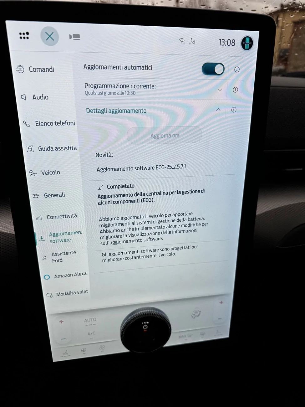

For the first time ever, after modules update and the rear camera recall by the dealer, I received an OTA update
But still no BC subscription
I have also era led power meter from ForScan, but There are a plenty of gray bars
Ford Mustang Mach-E 2021 Mach-E not receiving OTA updates IMG_5139
