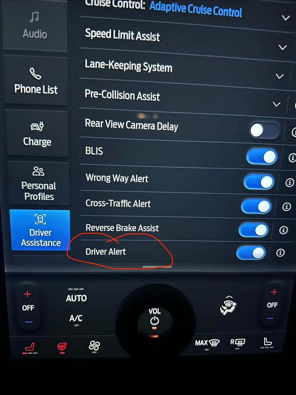

Do you have the warning about watching the road? Because after a mod with FORScan, I have it
Are you referring to the “Driver Alert” (Driver Distraction Warning)?
Yes
I already had it with the warning “keep hands on” only, but three days ago with FORScan and @rugedraw ’s help, I now have also the “Watch the road” alert that I didn’t have before.
Yes, I have the warning about watching the road after the BC update 24.2.1.6.2. Unfortunately Ford didn't enable the BC in Italy for model years before 24 and I think it is not possible with Forscan because it requires a server side activation by Ford.

Yes
I have this already in my car but no BC and no OTA. I see this warning works randomly.
