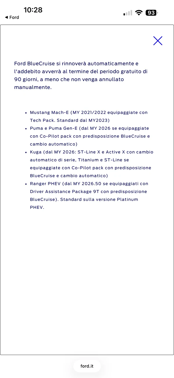

On Ford Italia website, now are listed also 2021 with Tech Pack

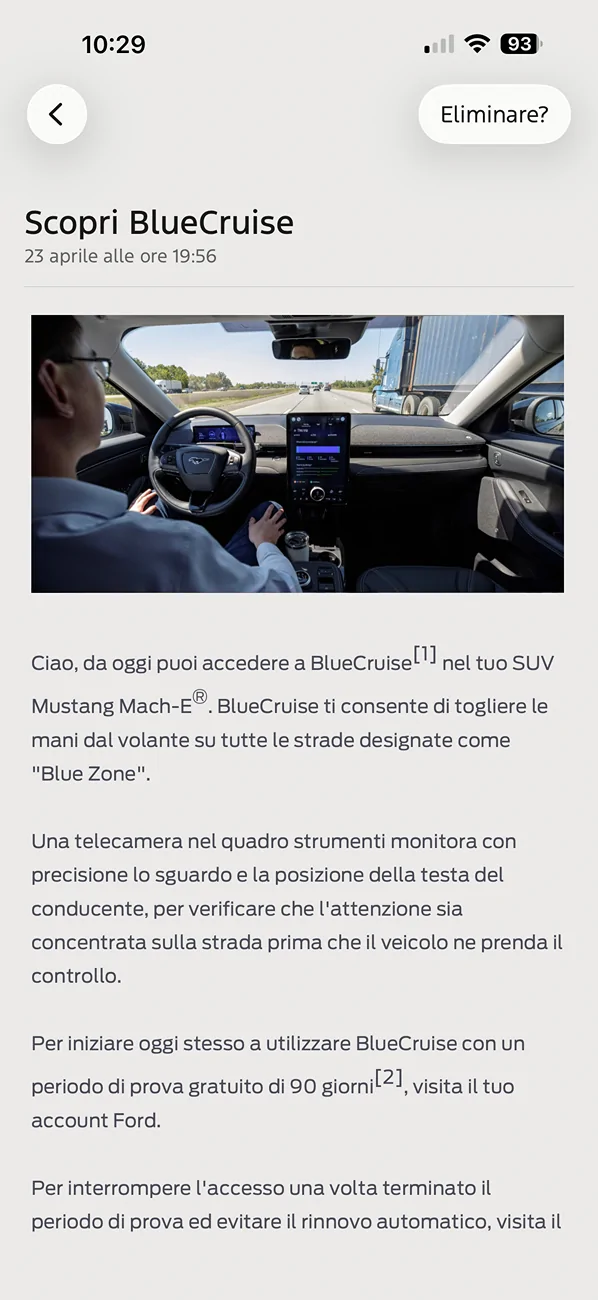

I attach here also the Ford app notification that I received
Thanks for the info. I hope Ford is extending BlueCruise to all models step by step.

@Aulander this is what I see on Ford website
Ford Mustang Mach-E 2021 Mach-E not receiving OTA updates Screenshot 2026-04-28 alle 17.17.20
Ford Mustang Mach-E 2021 Mach-E not receiving OTA updates Screenshot 2026-04-28 alle 17.17.30
