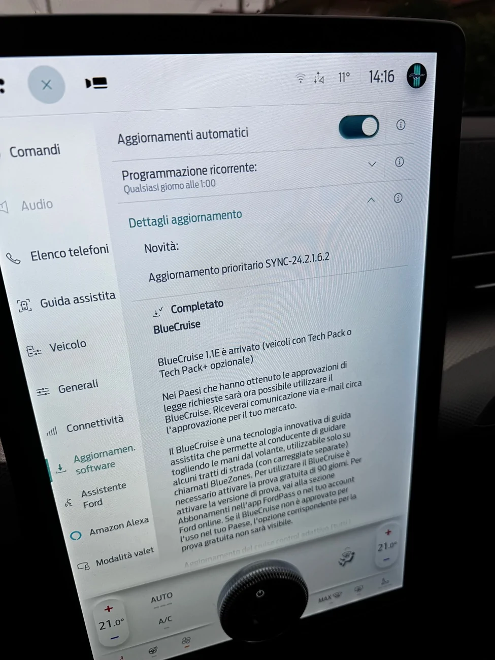

In the se days I received the SYNC 24269 revision 1387 with BC 1.1E
Ford Mustang Mach-E 2021 Mach-E not receiving OTA updates IMG_5278
I also found a bug probably
When I stop the car I have 1km/h ad ground speed even if I’m completely stopped
It has been resolved with other up
