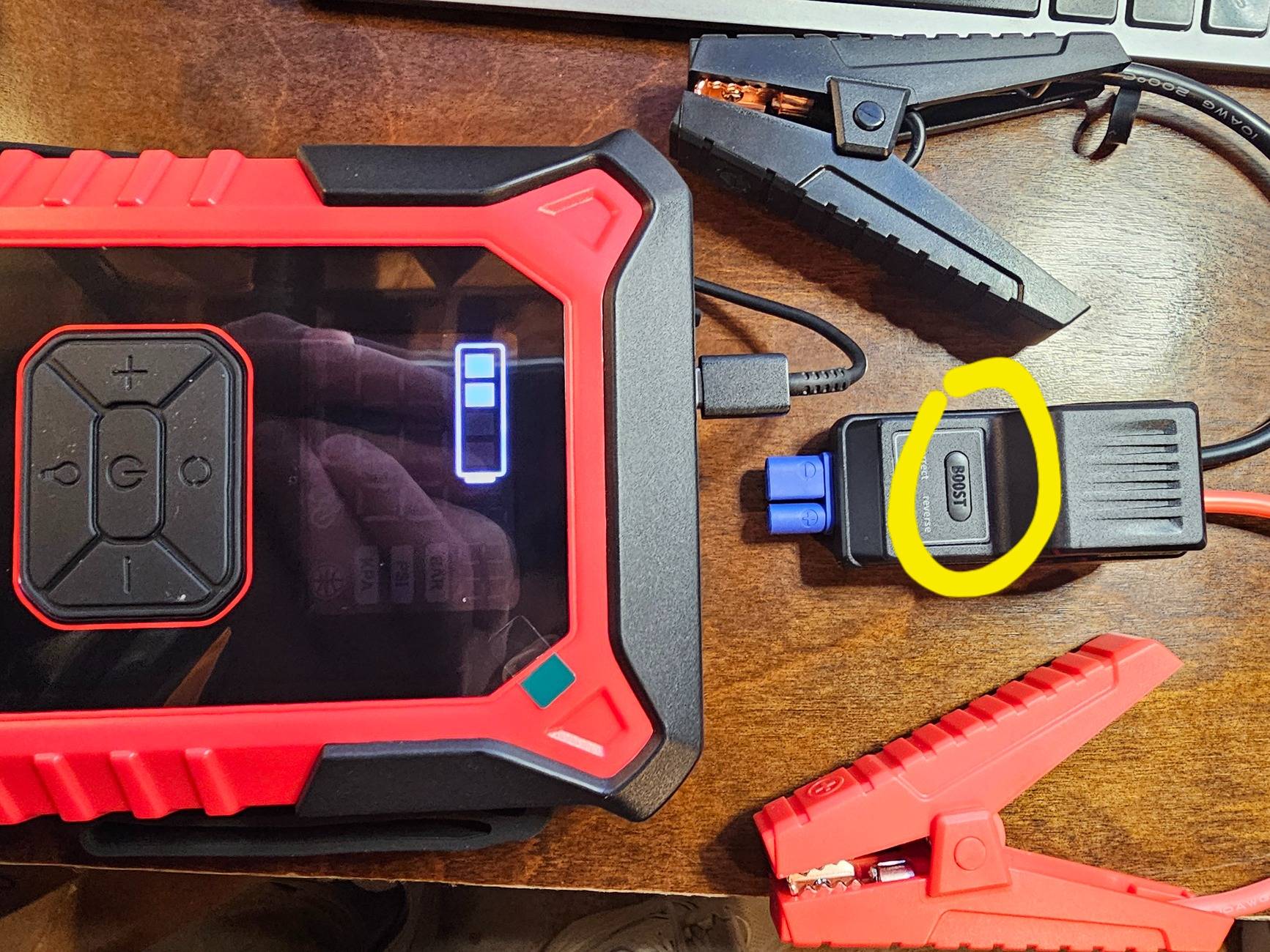

Yes I recommend either the NOCO brand which has the red exclamation mark button for the override, or the GOOLOO brand which has a BOOST button at the base of the cables.

Awesome! I have seen other people recommending GOOLOO as well. It's interesting that they don't have a good picture of the boost button or the manual for that model on their website. But for anyone else looking at the "GOOLOO A3 Jump Starter with Air Compressor" it looks like the boost button is here.
That is correct! The boost button is on the jumper cables attachment, not on the starter body.
