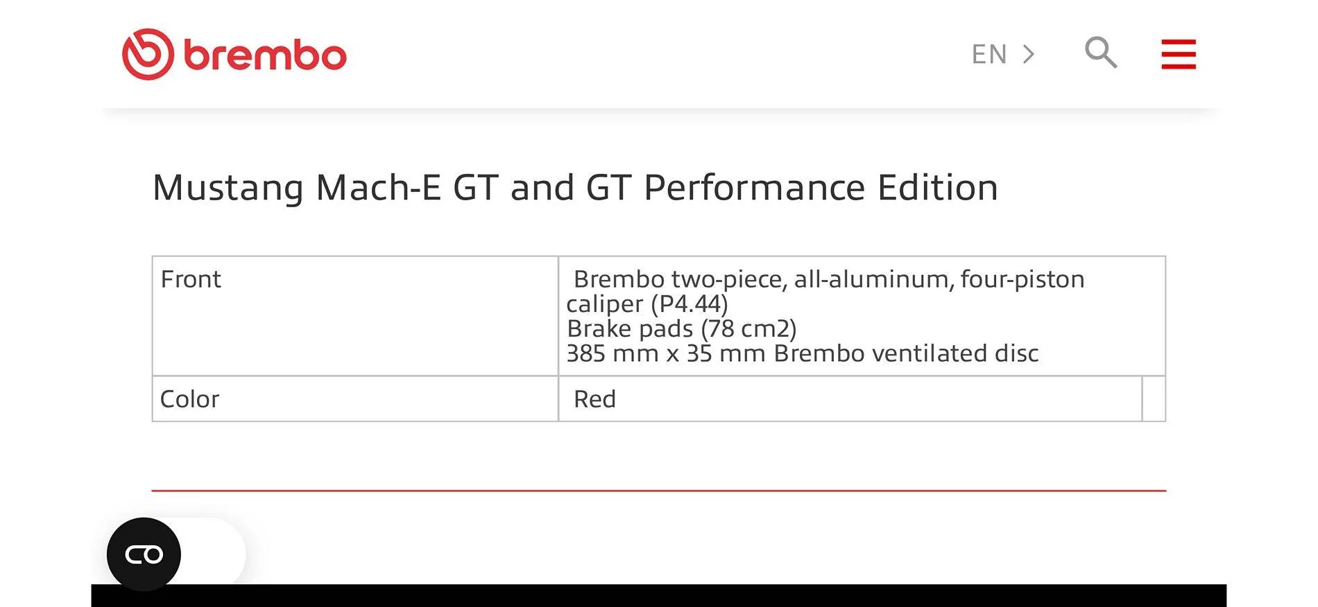

Here you go. Considering they take the same pads, I'm not sure if it's that big of a deal. Bigger rotors dissipate heat better and take longer to warm up.
GTPE
https://www.raybestos.com/disc-brake-rotor-682859fzn.html
Outside Diameter (Inch) 15.157
Outside Diameter (Millimeter) 385
GT (Pre 2024 and all other trims)
https://www.raybestos.com/disc-brake-rotor-682744fzn.html
Outside Diameter (Inch) 14.268
Outside Diameter (Millimeter) 362.4

While tires will make a difference in braking and handling, larger rotors make the performance more repeatable. The GT’s brakes faded and could not maintain level of performance where the GT-PE’s braking performance remained relatively consistent over multiple stops. That’s always been the reason to go larger in the brakes, not to get stopping distance. Stopping distance is more a function of how much traction can to muster on all 4 tires over the braking run. That’s all tire and suspension design, provided that the brakes have enough leverage and pressure to slow the car. ??
This pretty much nails it. First stop to first stop comparison, the difference is almost 100% tires. Lack of fade in the GTPE is about the bigger rotors, and perhaps pad compound, which typically has a huge impact but they may be the same.
