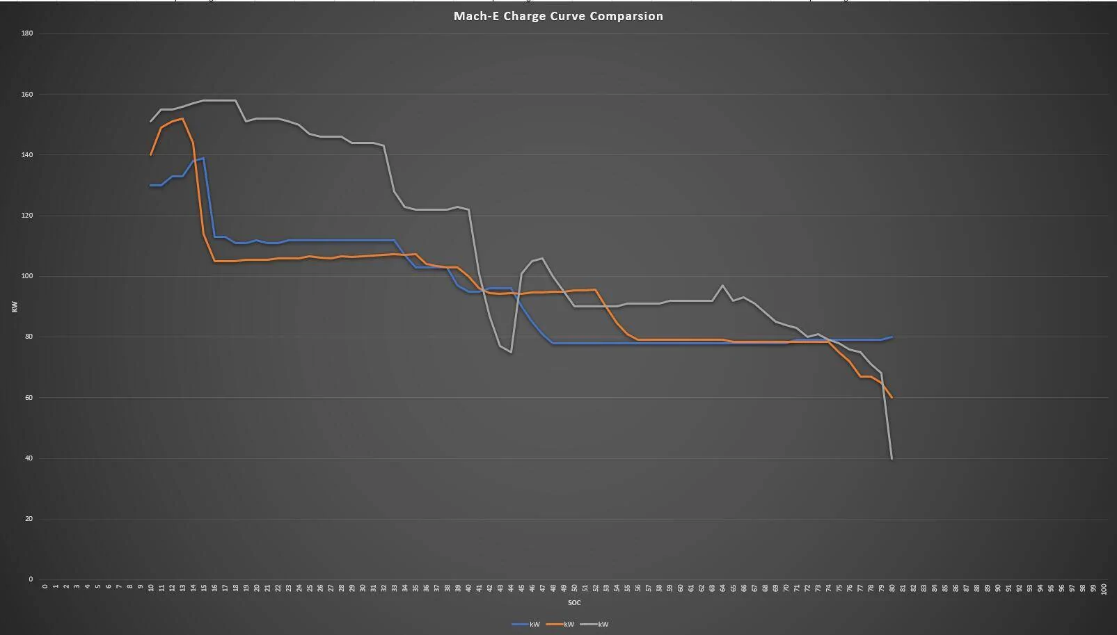

Ford Mustang Mach-E 2024 Mach-E charging curve comparison vs. 2021 Mach-E 1728309262463-b5
This is the chart for my most recent fast charge.
Car is 2024 MME Rally. This is consistent with what I saw on my road trip MI -> OK -> CO -> MI
Based on other sessions, the rate after 80% is ~40 KW to about 93%.

Its pretty interesting how the charge rate drops and ramps back up like that, not sure if it was thermals or just a constant amperage request, but still much better than the older cars
