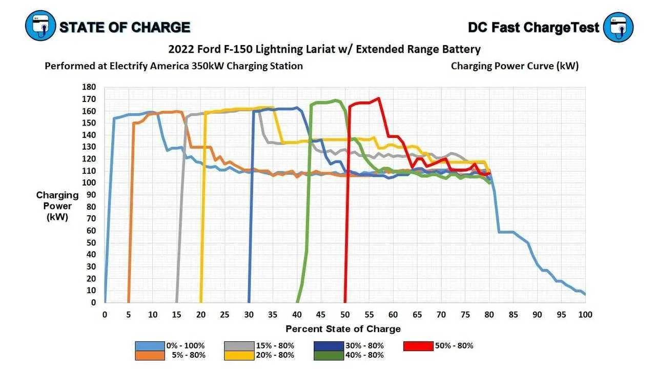

For sure! I used to be completely confident that you could slide the charging curve around and that it’d be nearly identical starting from anywhere between 0% to 50%. I’m not as sure anymore.
Lightning has (had?) the same strategy and it was well documented with Tom Moloughney’s graph.

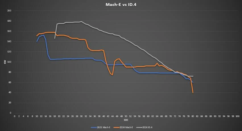

Hey again!
I decided to log the charge rate of my new ID.4 in comparison with my old Mach-E and the 2024 Mach-E with the new thermal modeling.
This charge curve isn't a perfect apple to apples comparison due to me using an EA station limited to 475 amps (idk why), and starting at a higher SOC of 17% compared to 10%. I also logged the Battery temp and was surprised of how hot the ID.4 battery gets. The mach-e never really went over 104F in my testing and usually seemed to have the A/C compressor at max rpm at that temp also. ID.4 was silent to about 110 when the compressor really spooled up. To note ambient temp was about 75 during testing and was done at night.

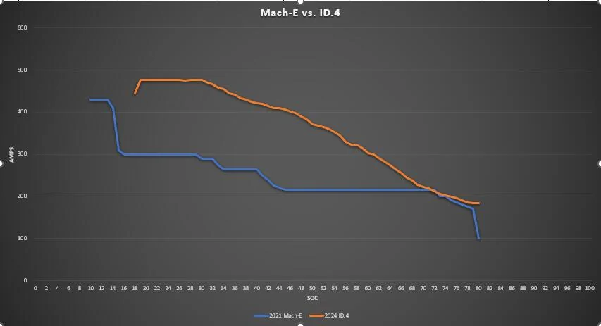

The 475 amp limitation of the charger was indeed a limitation. In previous experience, the car has drawn a full 500amps and was charging at 201 kW as indicated by the station. I forget what went into the battery but my guess was about 190.
The second graph is showing amp draw. Its pretty clear the ford used a constant current request while the vw does not. The ford had an interesting way of handling charging. It basically assumed everything was overheating and that it was worst case scenario. The charge curve acually allowed the max kW to be achieved all the way up to about 45% in my testing. The concept behind it was as long as you were under 50% or so, the car would take the same time to add 30% and 40% back to the battery. I believe it was 15 and 20 minutes. This was pretty much accurate if you plugged in dead or at 30%. IMO this way is dumb but for the uneducated EV driver their car tecinally performs as advertised regardless of their poor road trip style.
Pretty crazy how much the ID.4 is ahead of the Mach-E. Its a substantial difference. This 17 to 80% only took me 24 minutes, and the ID.4 is more efficient. Hopefully, a chemistry change will come for the Mach-E.
Something else to note is the delta T for ID.4 is much less than the Ford, only around 5 degrees F compared to upwards of 15-20 in the Ford. It is surprising considering they use a similar cooling strategy.
Also who knows if the 24' charge rate will fry junction boxes or not lol

The ID.4 has a nice smooth charging curve Ford should aspire to. I think the Mach-E is limited to 450 amps or less, so a charger limit of 475 amps will still provide max power unless there is also a charger power limitation. I have not heard of anyone getting more than 165 kW in a Mach-E. No offense, but I think you’re misremembering seeing 200 kW on a Mach-E.
Ford is excessively paranoid about the cell temps and limits it to only 104°F. They should allow up to 122°F during DC charge like everybody else does (Tesla goes up to like 140°F). I think the ID.4 uses similar LG cells, so I’m really not sure why Fords charging curve is so nerfed in comparison.
