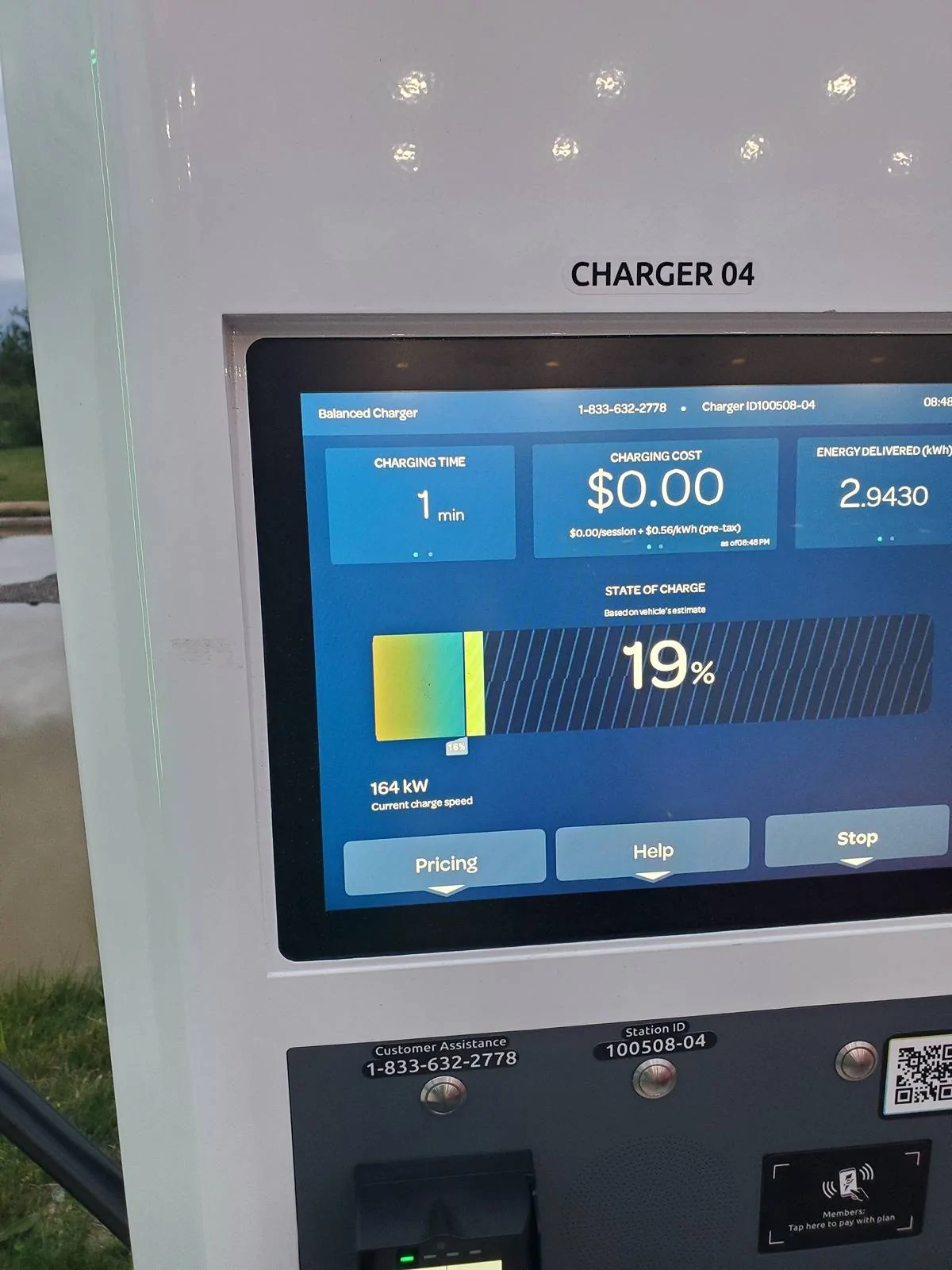

Just came back from a 800 mile road trip. My 21 Premium Ex hit 164kW at an EA 350 station in the last 90 minutes. 2 minutes later it sognificantly dropped
Charging curve? Hard to tell as various stations give various kW at similar SOC. Updates: I am sitting at 6.14.0
Ford Mustang Mach-E 2024 Mach-E charging curve comparison vs. 2021 Mach-E 20240609_204823

That's normal for mach e. I believe it's around 130 seconds it does peak speeds. I'd be interested to see when you dropped under 100kW. Also remember even if it's warm out the battery heater usually kicks on until batt temp reaches 95F. So it's adding about 5-7 kw to what's actually going into the pack

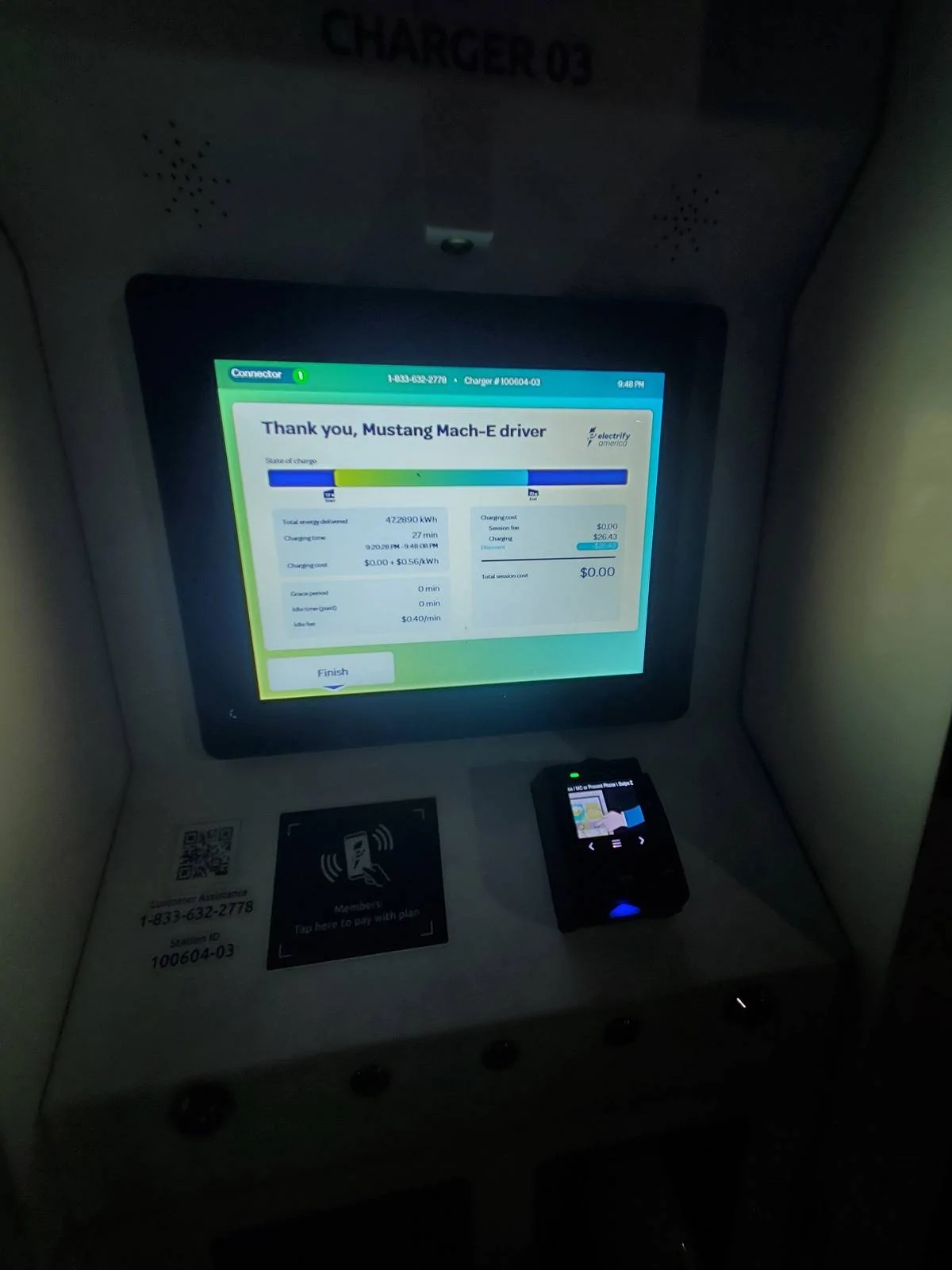

27 minutes to add 47.23kWh. If this means anything for Darrell Palmer's statement
Ford Mustang Mach-E 2024 Mach-E charging curve comparison vs. 2021 Mach-E 20240607_214832
