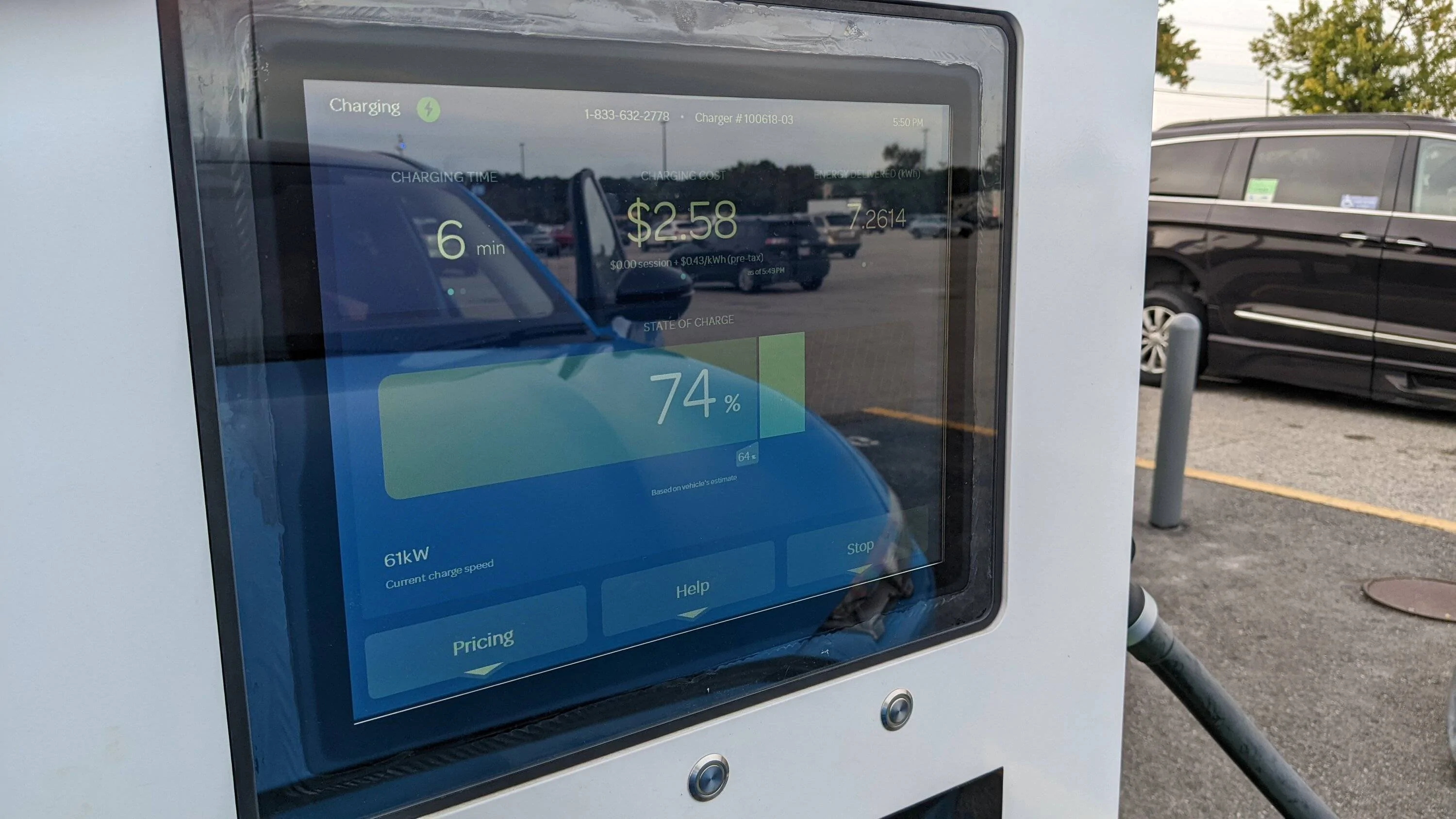

You all are missing the point. This is my third Mach-E over the past two years. My first was a grabber blue First Edition. My second a cyber orange GTPE (which I still have). My third is my wife's PE (which is in the picture). I used to regularly see charging rates north of 150 KW. Now I'm lucky if I see 110 KW. Just last night at 45% SOC and 55 degrees F ambient temperature, the most I saw was 76 KW.
I'm guessing that Ford has slowed down the charging rate at DC fast chargers due to the problem with contactors welding shut. I'm wondering if anybody else has experienced a slowdown in DC fast charging as well?

You are describing a charger problem, not a vehicle problem IMO.

also 110kw is kind of the normal charge rate for the car after that initial burst to 150kw (if its allowed to). It drops from 110kw down to 60kw right until 80% then it drops to around 40kw and tapers off at 95%.
This only applies when the battery is warm. all rates are reduced when below 70 degrees. this car is not a very fast charging car and nothing has changed to make it worse.

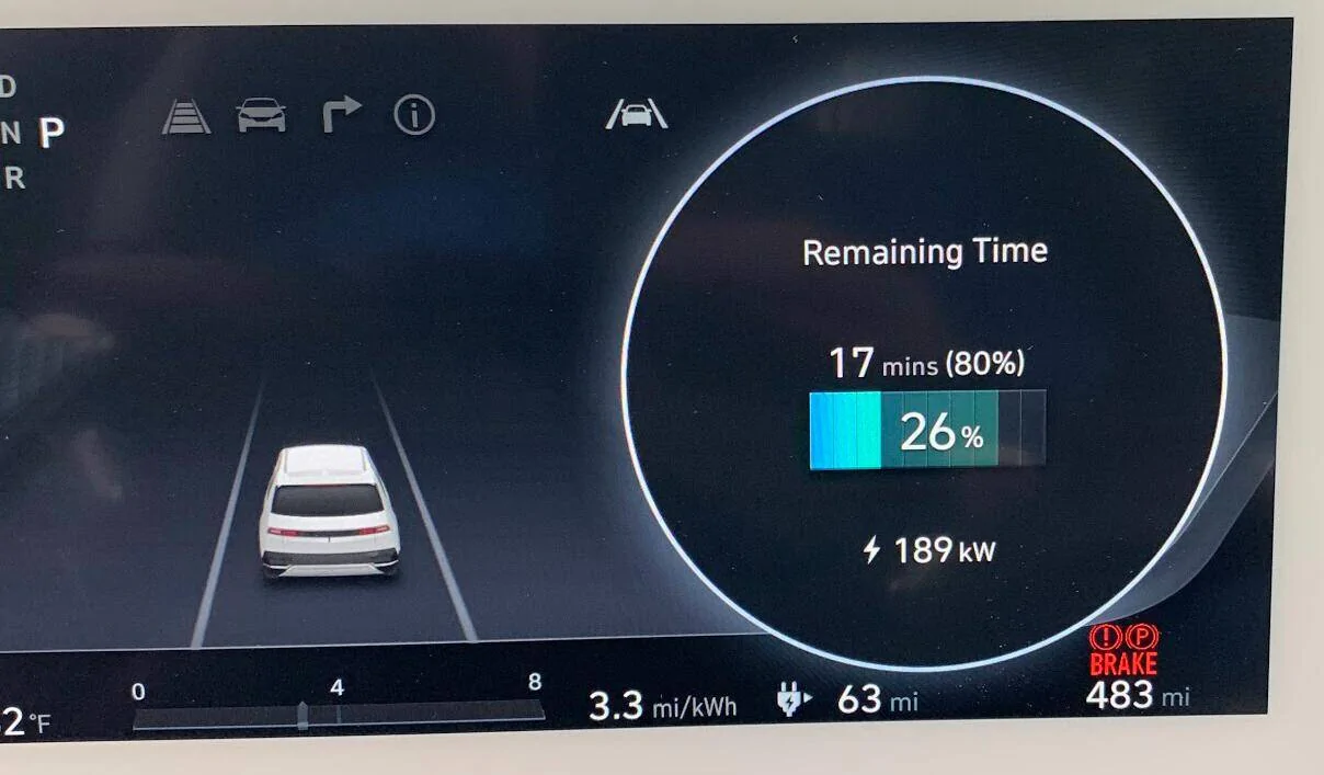

Yes 14%-80% in 20 Mins with Kia Hyundai is pretty cool. The highest I saw was 195 kW.

Ford did not change the charging curve with the recall update.

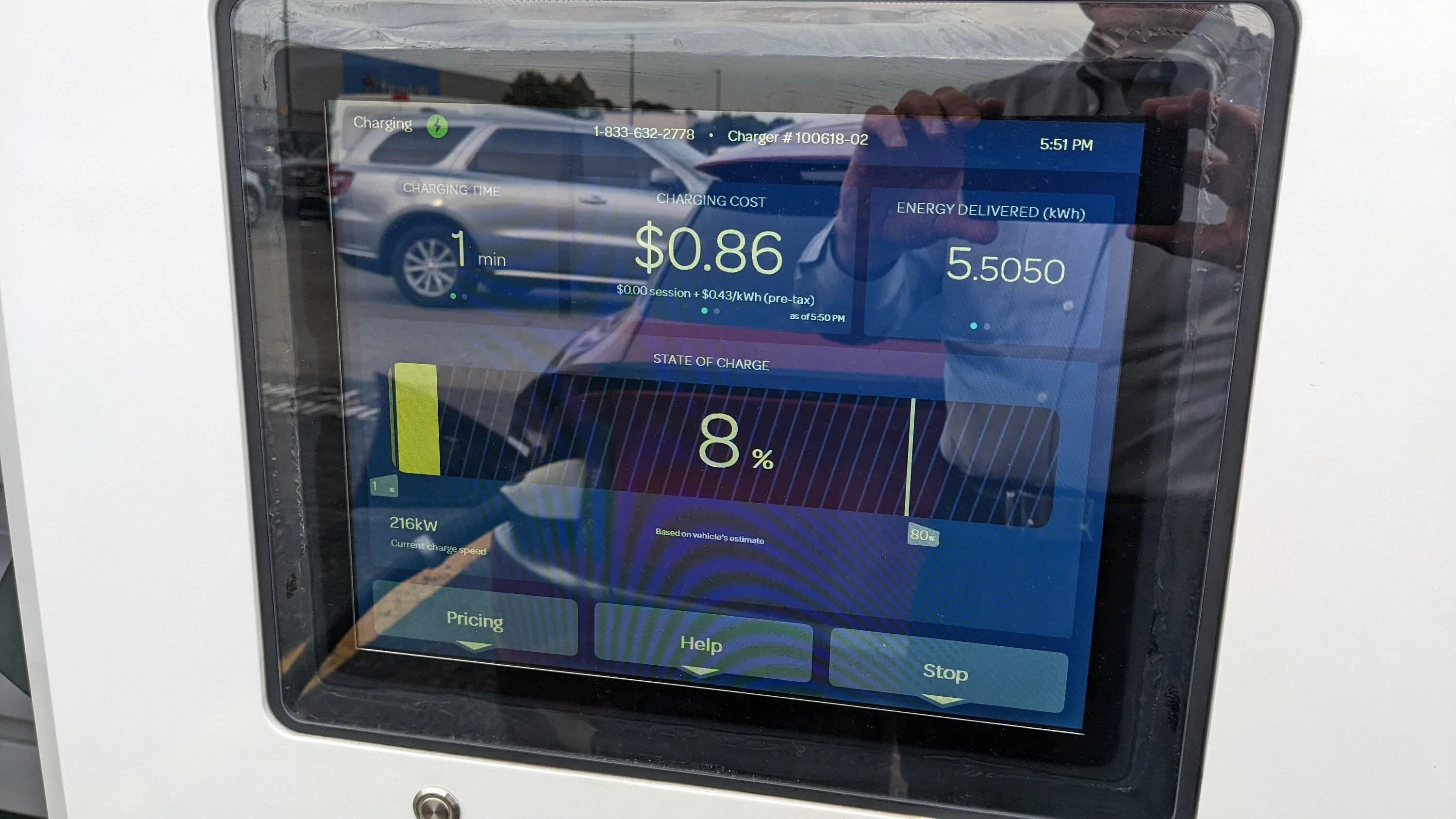

That's a 300kw charger the Korean EVs will do 230kw all the way to 80%
That's not at all true. There are no EVs that will do their top speed all the way to 80%, not even close. Peak charging speed is just that and even in the highest end EVs it tapers off fairly quickly. The KIA/Hyundai will still do the 10-80% sprint faster than an MME, but not holding 230 all the way. Countless YouTube charging tests that show the same.

i regularly charge my hi5 10 to 80% at a constant 220-230kw on 350kw ea chargers.

I regularly don't believe it unless there is something wrong with your car because that would be rough on the battery.
Above 50% on any charging video I found, it drops to the 150-170 range.
Still great, again I never said that that platform doesn't have great charging speeds for the price. But if you have a 10-80% 220-230kW HI5, then I would record that, as that would put it ahead of some of the monster chargers like the Porsche Taycan which has a higher charge max but also can't hold it through the entire charge, that would just be hell on batteries.
