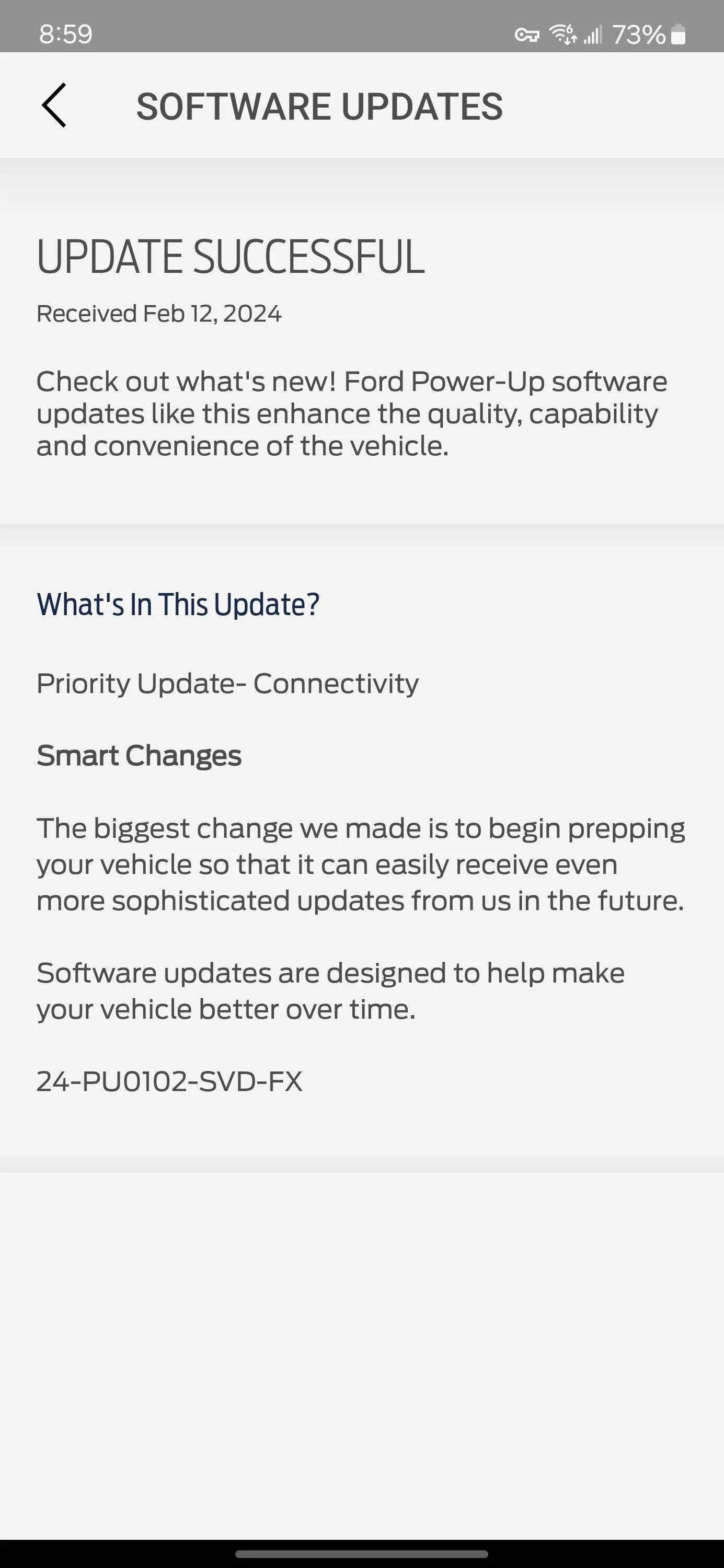

That new ex-apple guy must be writing the new release notes
“this is our biggest and best iPhone ever released”
Now just put what the update actually updated below that and it’s perfect.
I haven’t received this update yet but hopefully soon™
update: got it a few hours after this post.

Got this update as well. My answers in the survey all reference that I have no idea what the update even did and the change notes aren't helpful. Also got no alert or message in the ford app about the update like I usually do. Just the alert in the car.
Your response was exactly the same as mine, except I did not even get it in the car. I only knew because I got the survey request.

I got this today too. I can't tell that anything is different. The last update I got was 6.7, and I'm in EA ('22 GT)

Anyone else see this update? Like everyone else, have not had a update in a long while, but this one showed up this morning with an immediate email from ford asking me to take a survey about it.
Of course release notes are weak, so that does not tell me anything other than this is an update to help future updates.
Any other notes or knowledge about it that I may be missing?

Got it today too, after receiving 6.7 yesterday. 12V battery SOC was about 60% when I got it.
