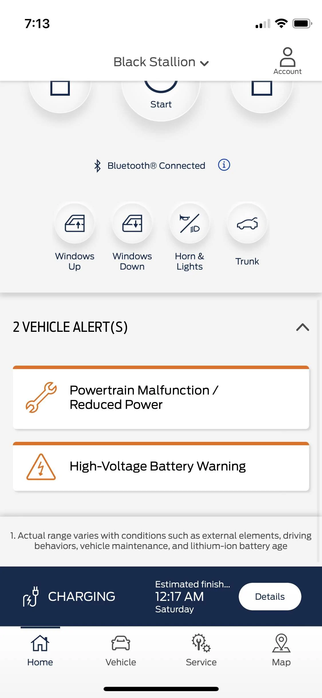

Today on my way in to work it has failed a 2nd time at 32k mileage. No warning was going up a hill and then limp mode per say. First repair was at 23k, the only problem I really have with Ford is they will not give me a rental car for my inconvience at any dealership in san antonio not even for the recalls WTF!
Ford Mustang Mach-E 2nd HVBJB failure Image[528433]

Yes it was the new HVBJB, made a whistle during acceleration. It didn't even last 10K :(
This is a bummer that your car failed in some way again.
Do you have a OBD-II reader? these cost $20 on Amazon, and with one and a free app Car Scanner, you can read the Diagnostic Test Codes (DTC) that your car sets to let the dealer techs know what is precisely wrong with your car.
I wonder whether it is your HVBJB that failed again -- it seems to be pretty rare that the redesigned part fails, so I just wonder if something else is causing your issue.
In my experience, an HVBJB failure makes no sound.

No OBD-II reader. By whistle I mean it was noticeably louder upon replacement during acceleration.
