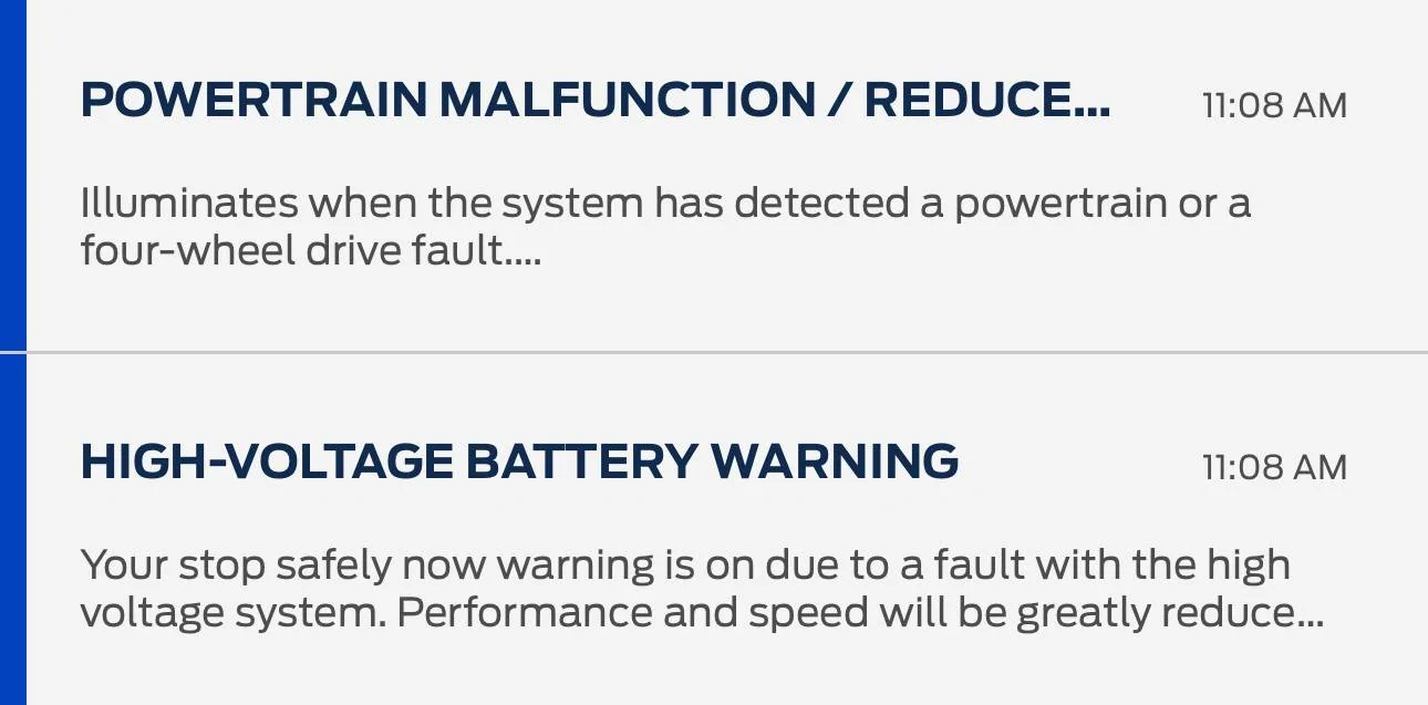

High voltage battery warning means high voltage battery warning. It’s his HVBJB.
While it very well may be his HVBJB has blown based on the OP's subsequent posts, your statement is absolutely false. These indicators are more or less the equivalent of the check engine light on an ICE car. There's specific DTCs which correspond to a blown HVBJB but a number of different conditions may result in a high voltage warning. Or, it could be an erroneous error/message that will go away: https://www.macheforum.com/site/thr...ng-service-vehicle-soon-while-charging.26983/

Just dropped off the vehicle at Heiser Ford in Glendale WI. I explained to them that it took nearly 3 months to get the last one replaced and had to take it to the other shop across town to finally get it taken care of after a dozen visits and just as many phone calls. The manager on duty was very receptive. (I was not being a dick about just explaining the history and I get shortages and new cars and technology)
He said he would have his tech look at it ASAP and he was a man of his word. I got a call 2 hours later and they reviewed the data and issue and I was correct on the diagnosis. It was the HVBJB again. They said they are ordering a new part today and hope to have me up and running in 1-2 weeks. I'll be updating this as I get more details or if things change.

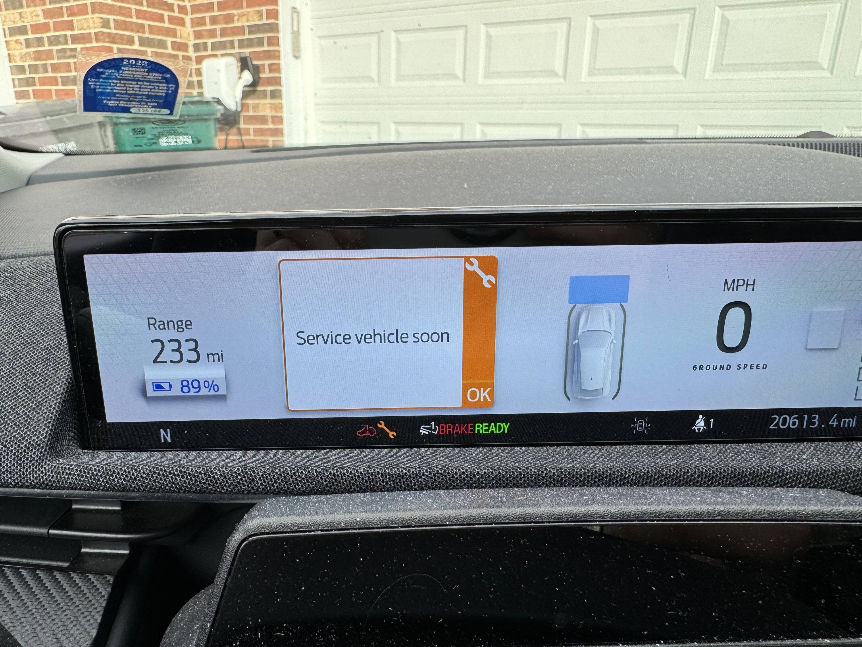

Well, it’s been a year and I was told I had the upgraded HVBJB unit and now it looks like it’s broken again. reduced power and maintenance light request again :(
it looks like the new unit has the same lifespan as my original unit.
