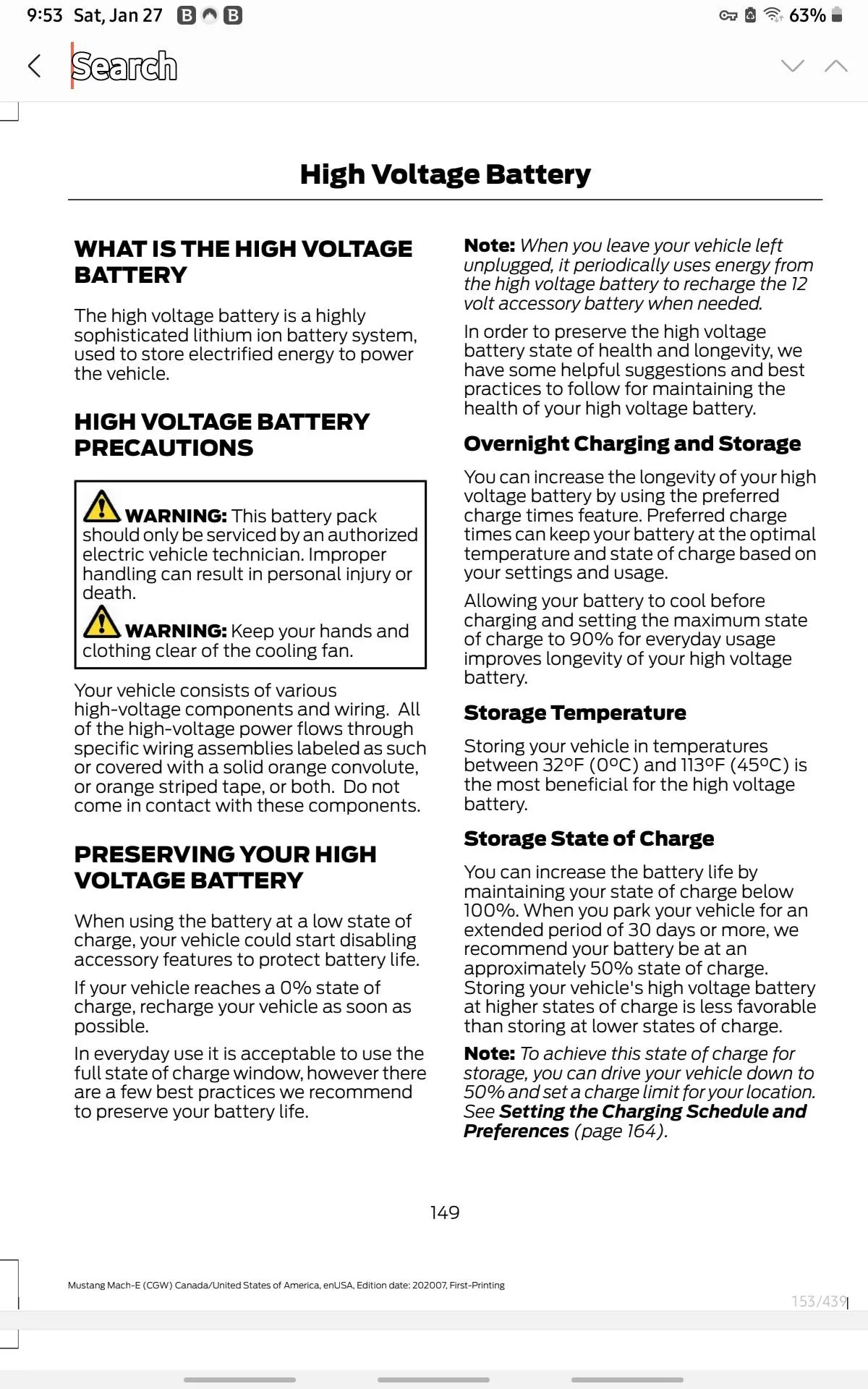

I don't worry about it and just do what these chuckle heads recommend. I figure they must know something about it!
Ford Mustang Mach-E 3 Common Mistakes That May Harm Your EV Battery - Engineering Explained Screenshot_20240127_215319_Samsung Notes
