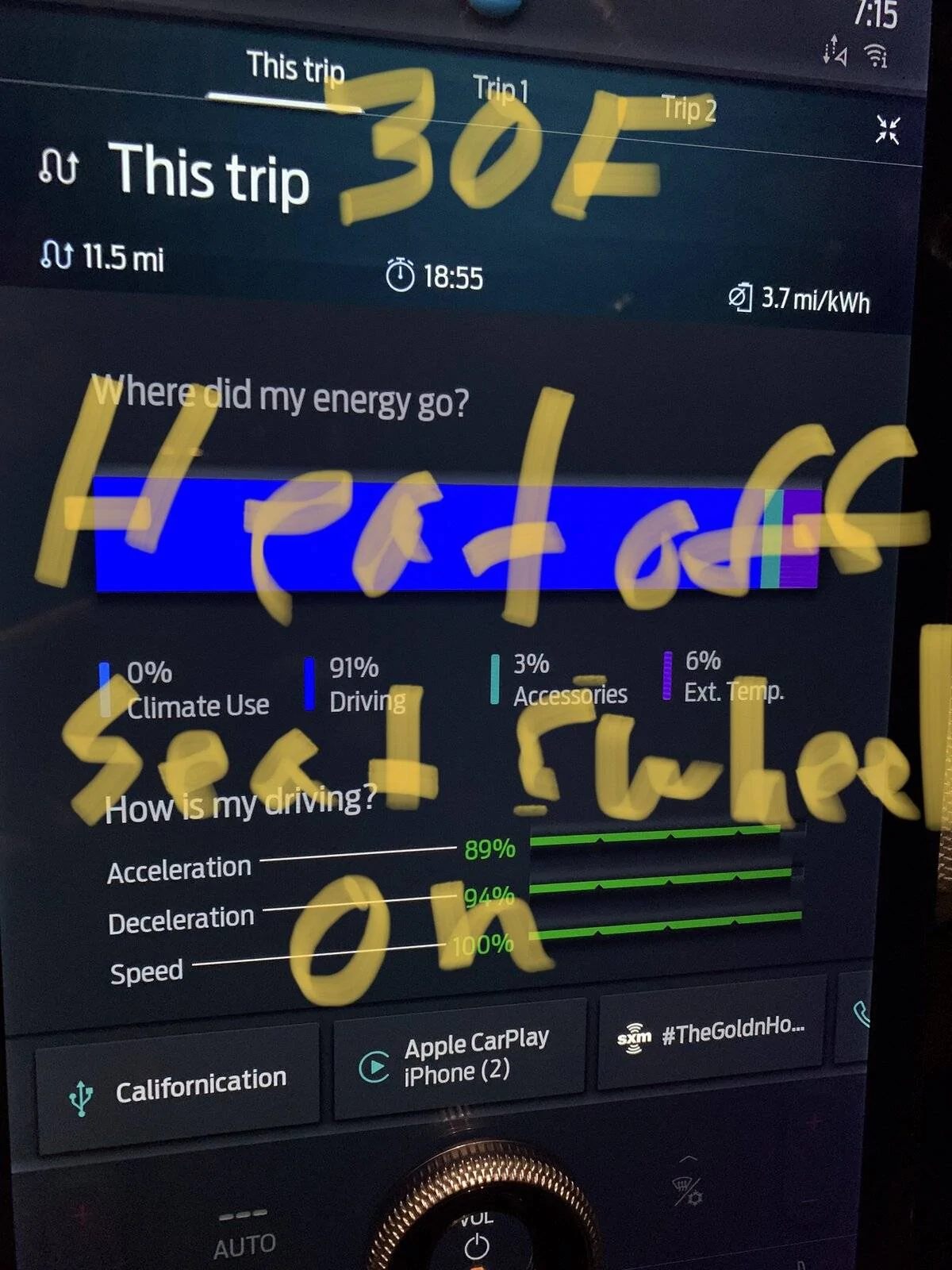

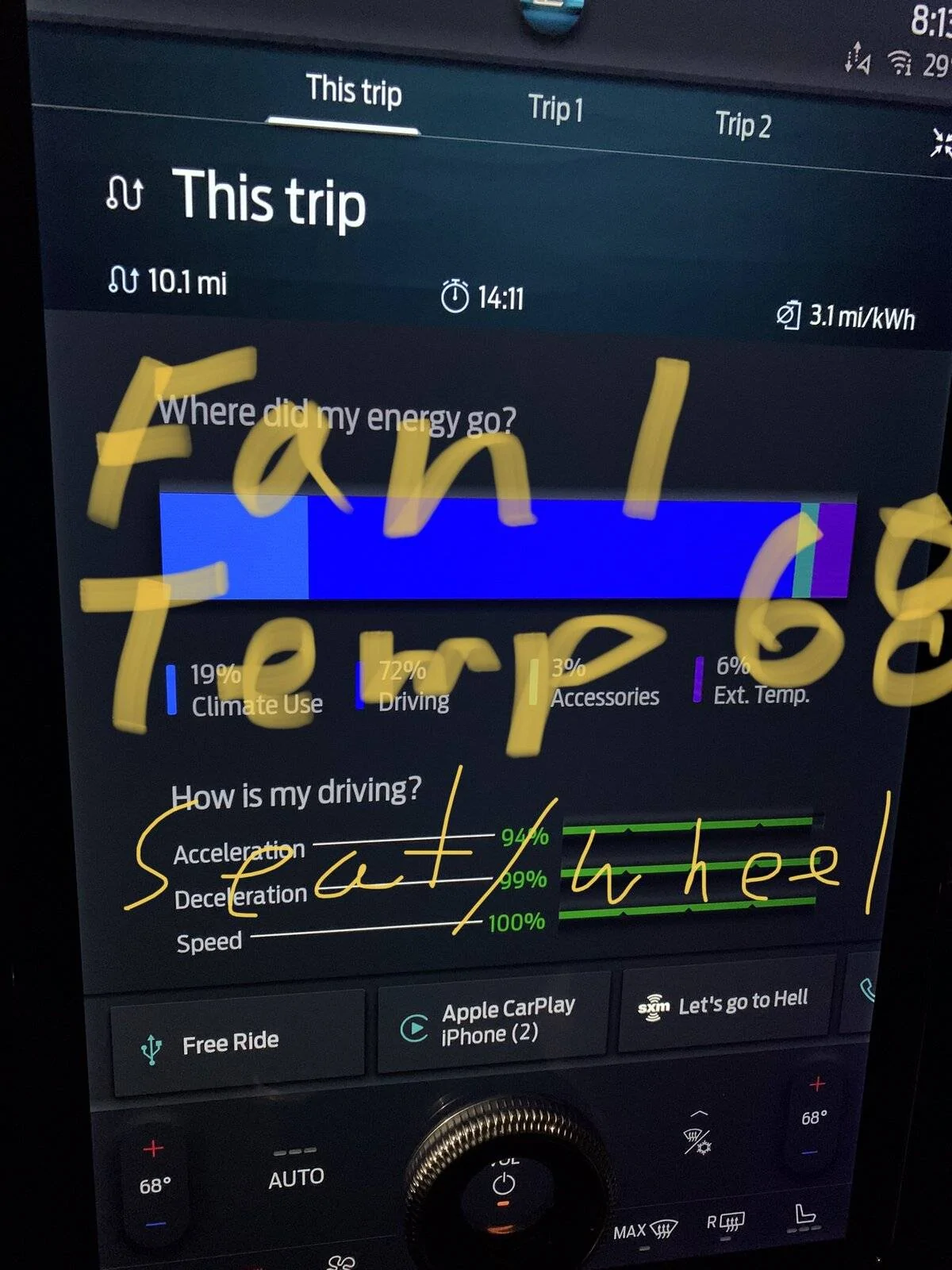

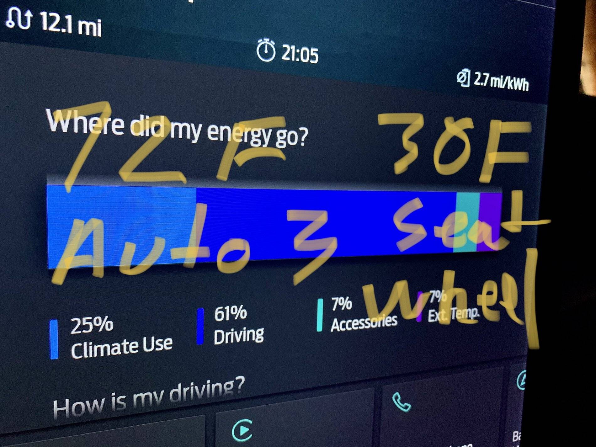

I had to take my daughter and a friend to a high school homecoming dance and pick them up. I decided to do some heating tests. 29-30F.
1. Auto 3, 72F, seat and wheel heater on, 40 MPH average 2.7 mi/kWh
2. heat off, seat and wheel heater on , 40 MPH aversge, 3.7 mi/kWh
3. e heat set at 68F, Fan on manual 1, seat and wheel heater on, 40 MPH average, 3.1 mi/kWh

Think this is very useful. Even if it’s not in laboratory conditions. I will use setting 3 on my day to day in winter to see how it goes.

I just did a journey with fan on 1 and heat on 20c (68f) and had 3.1kwh. Usually heating on means it’s around 2kwh.

Are these on different days, or how did you let the car cool off to the same temp for each test?
Same temp, same day these were all done last evening. Similar traffic too.
All jaunts were 10-15 miles and I had 4 With the same speed limits and similar Elevations and roads. Fair weather too. It was the perfect opportunity as I had to pick up “the friend”, take them to the dance, return home, go get some items at the market for the wife, return home and then go get them from the dance. It just was an ideal time. No cooling off time. I only had about 20 mins max down time while stopping between tests. Consider it a steady state test starting at the same interior parameters each time.
The only difference was number of people in the car. I used intelligent cruise for all.
