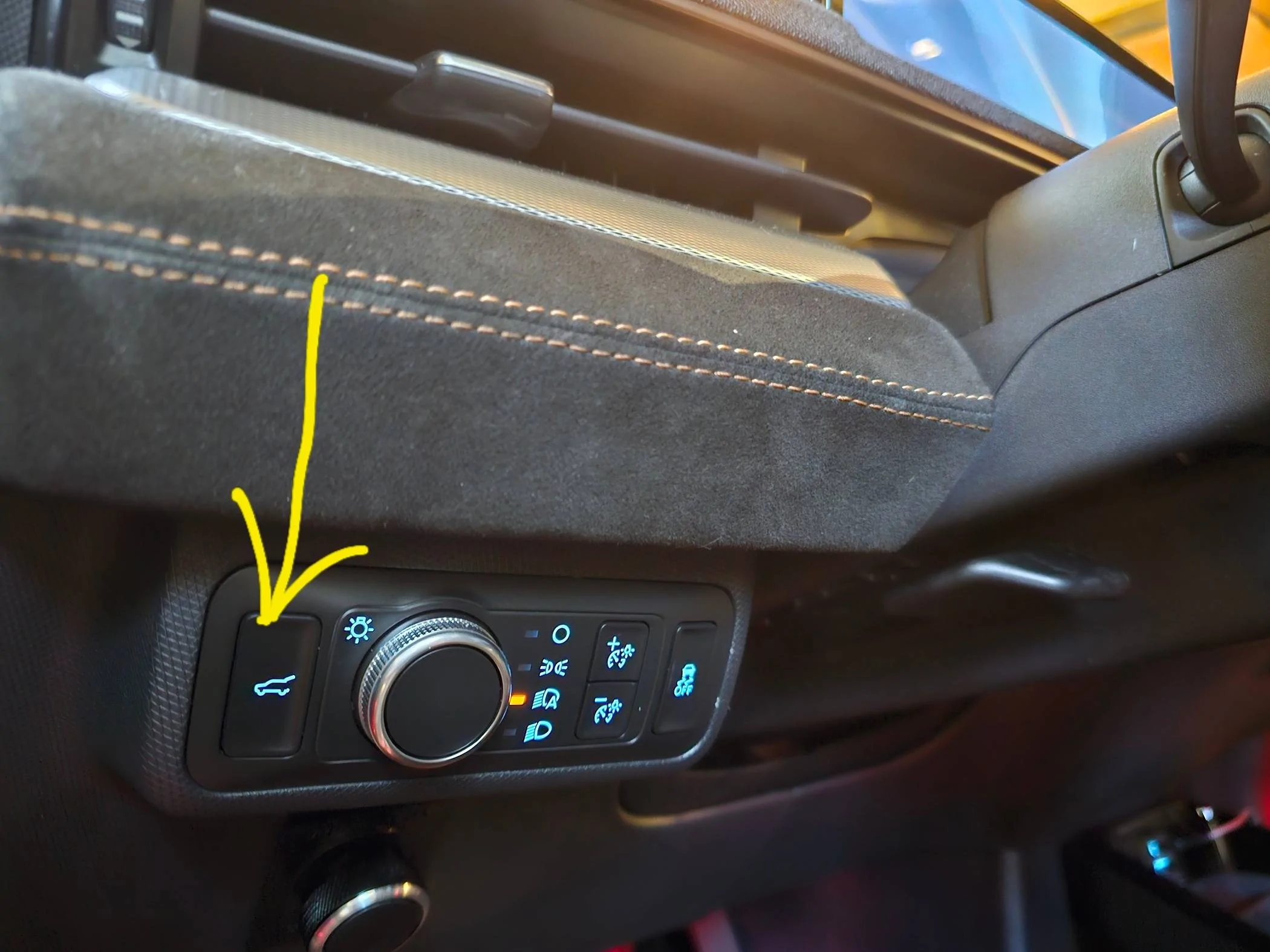

Dude, you can't find the hatch button? It's right here:

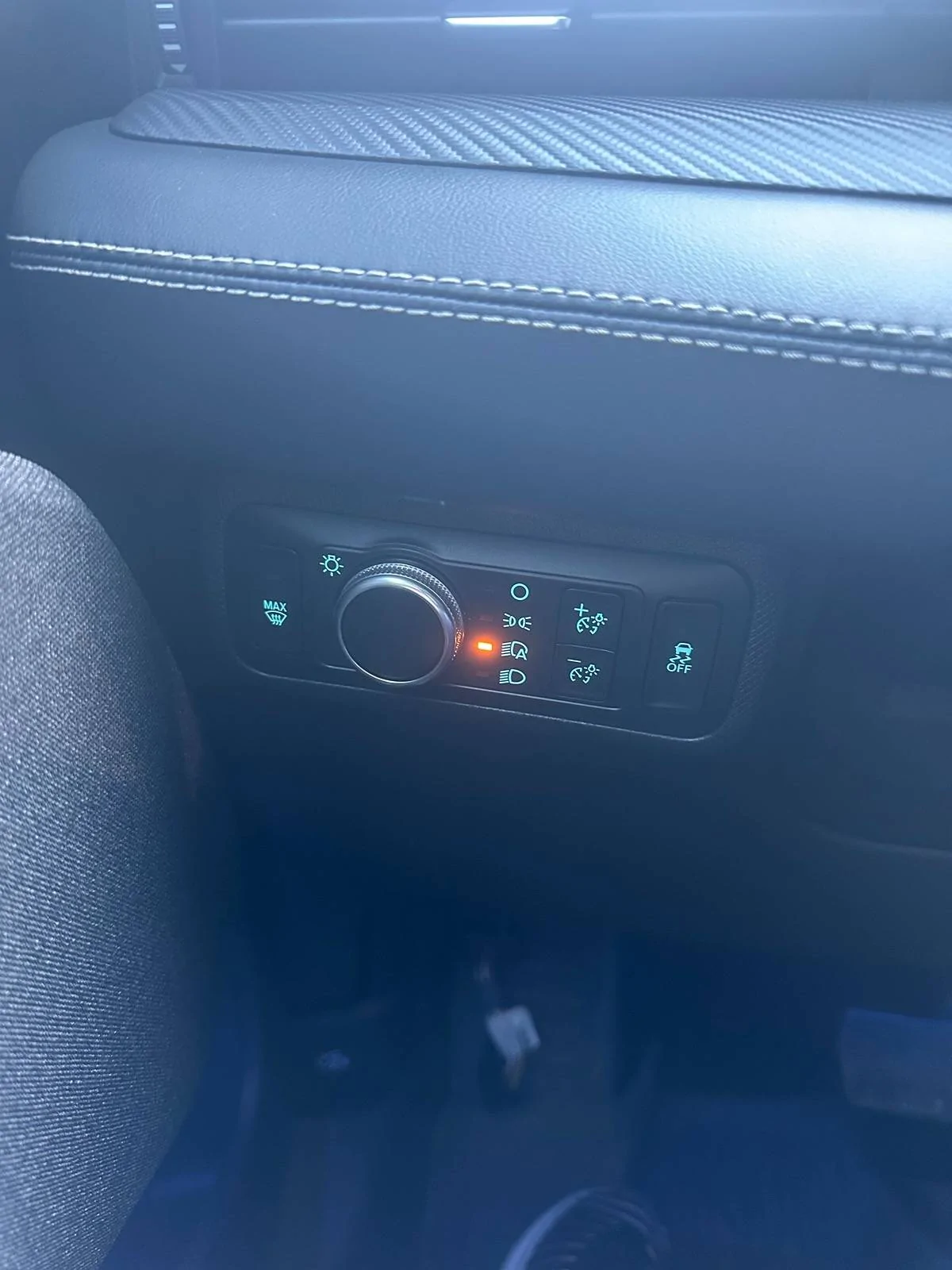

How hard was it to swap the button?
It was the easiest mod I have done to my car. You have to run one wire, pop off the idiotic max defrost button that nobody uses, and pop on the hatch button.
Connect the wire to the new button and the fuse box in front of the passenger footwell, and that's it. So easy. It takes about 30 minutes. And I use it every time I go shopping.
@markboris did the original work to put one in, and this is an iteration on his groundbreaking project. I will find the thread and update this post with the link.
Here is the thread link: https://www.macheforum.com/site/threads/adding-an-inside-liftgate-power-switch.6560/
It's long, but I will find the page where you can use a new hatch button in the headlight switch assembly. I got one for an Explorer off of eBay for around $30.
