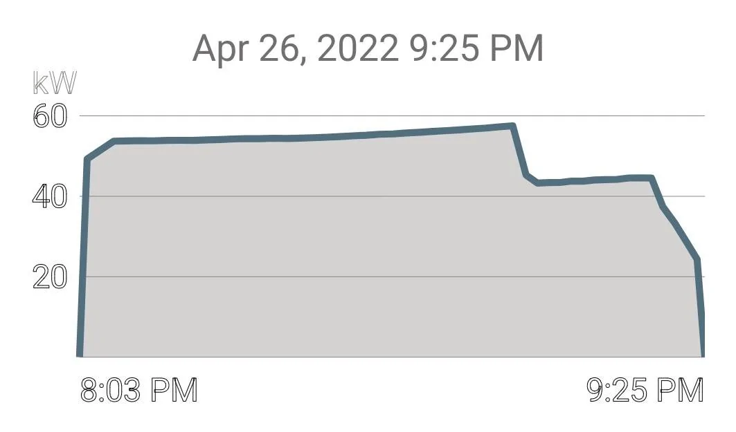

In regards to the charge curve update from 80-100% (21P22), it's actually just bumping up the power from ~11kW to ~43kW. It's typically 80-125kW for the 0-80% SOC area before that, and the update doesn't improve that part of the curve.
Since it's still way below peak power, seems unlikely this particular upgrade would have any impact on the contactor issue.
I guess we'll find out once we know what the software change actually does...
