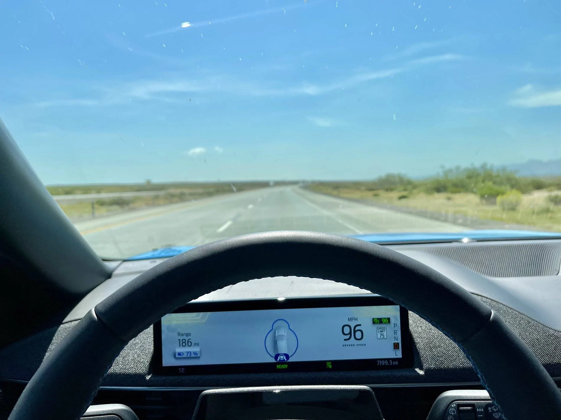

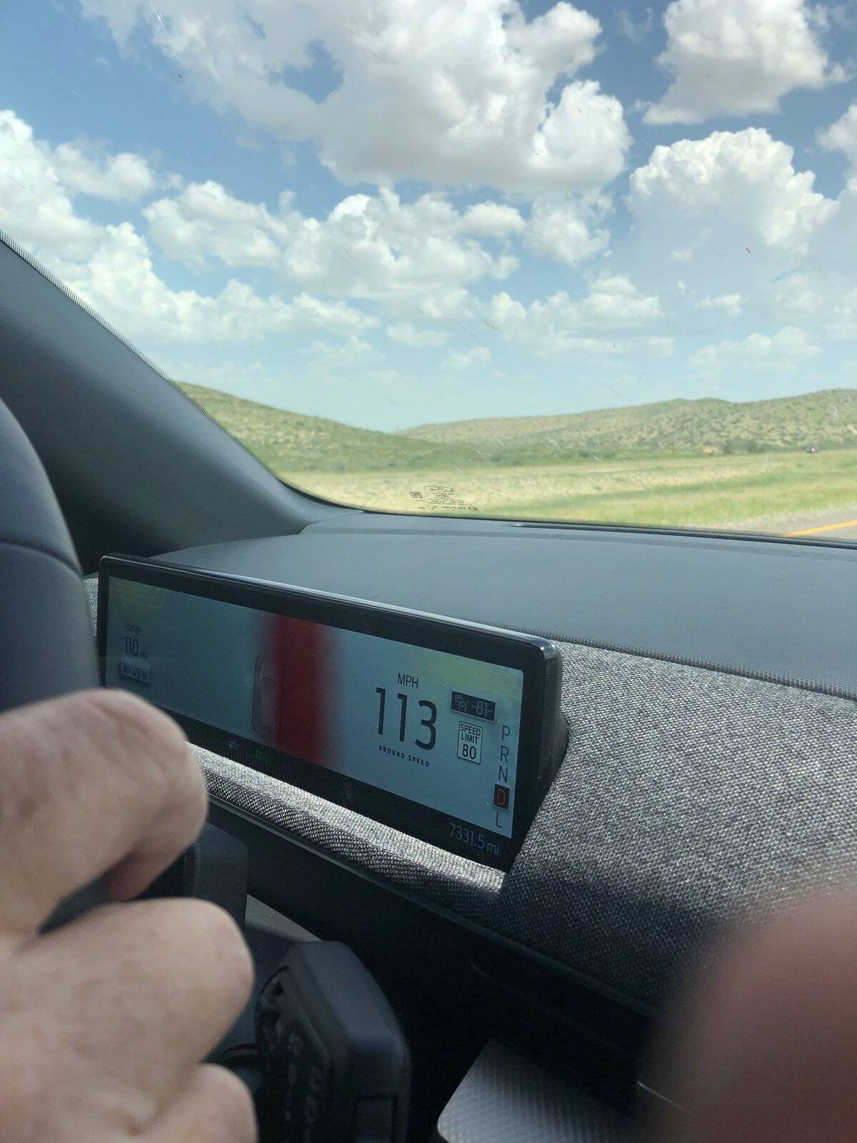

We had no A/C problems in 105° TX heat while cruising at 96MPH to 113MPH. The A/C was on auto (1) set to 69°.
So it seems to just be more software issues related to my vehicle from when they did my instrument cluster screen replacement... what a bummer. Thank you for bravely testing this out!
